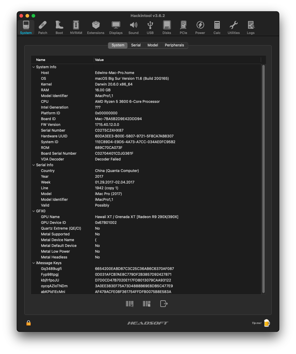

Message is gone. I updated some files and now everything is ok! Just no Metal still :-(Looks like it's all enabled correctly there. Which PAT patch do you have enabled?

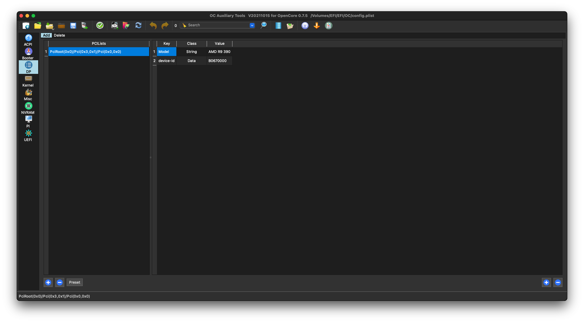

radpg=15. I'm unsure if it'll help but worth a try.Ok, I’ll try!I'm assuming you've got Whatevergreen.kext? If you do, add the boot argradpg=15. I'm unsure if it'll help but worth a try.

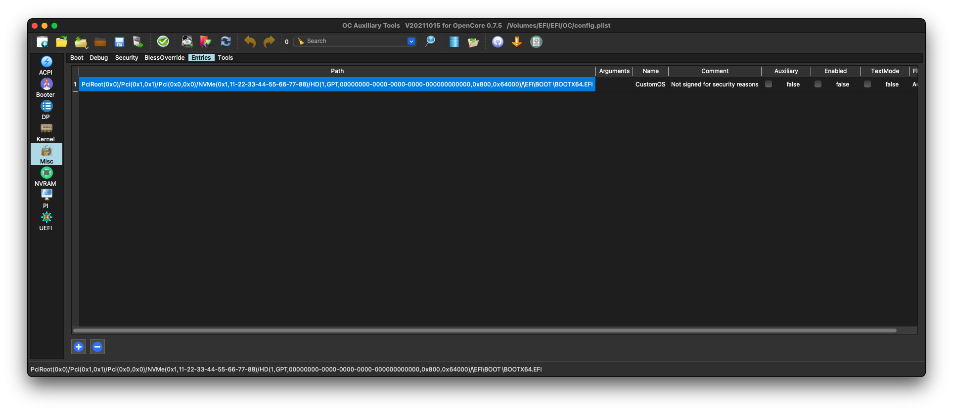

msibase=0x90 for though? Also if you need to use -no_compat_check then you're using the wrong SMBios.I don't know, so I deleted it. Both by the way and no issues booting MacOs. But Metal is still not working.Position doesn't matter no. What ismsibase=0x90for though? Also if you need to use-no_compat_checkthen you're using the wrong SMBios.
Yes, YouTube plays without any hiccups. I wonder if I delete everything but the ssdt you mention, will it boot then?Only use SSDT-EC-USBX-DESKTOP.aml but this wouldn't affect the GPU. Does YouTube etc play at all?
Ok, it plays 4K video flawlessly also.What I meant is that you shouldn't use two different EC SSDTs. If YouTube plays without any issues I don't thing there's actually an issue with the GPU working. Just a cosmetic thing.
