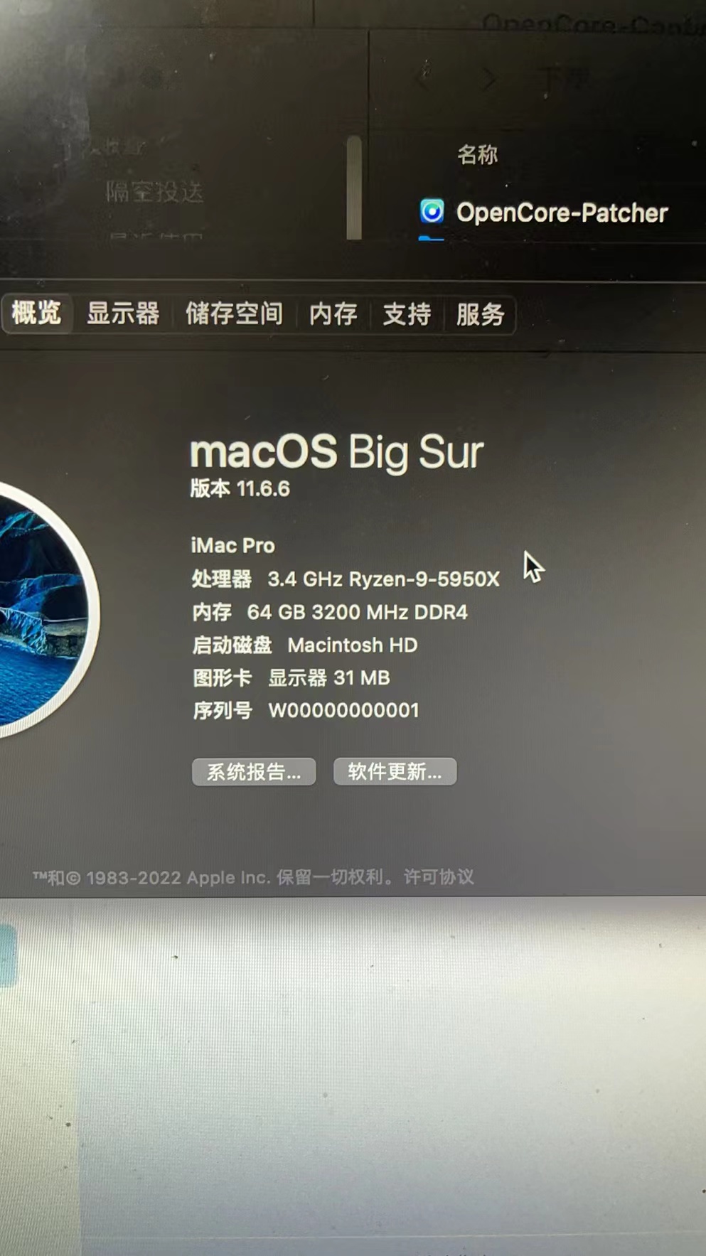

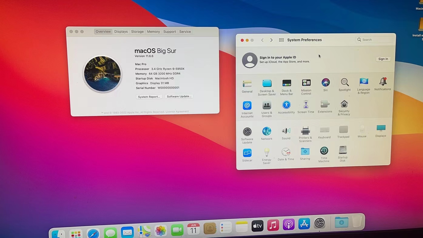

lpfwork
Jun 11, 2022
6
I try to install it on a USB stick. It can work, but does not recognize M2 hard disk and SATA hard disk. PCIe WiFi is not recognized. EFI also uses Big Sur.

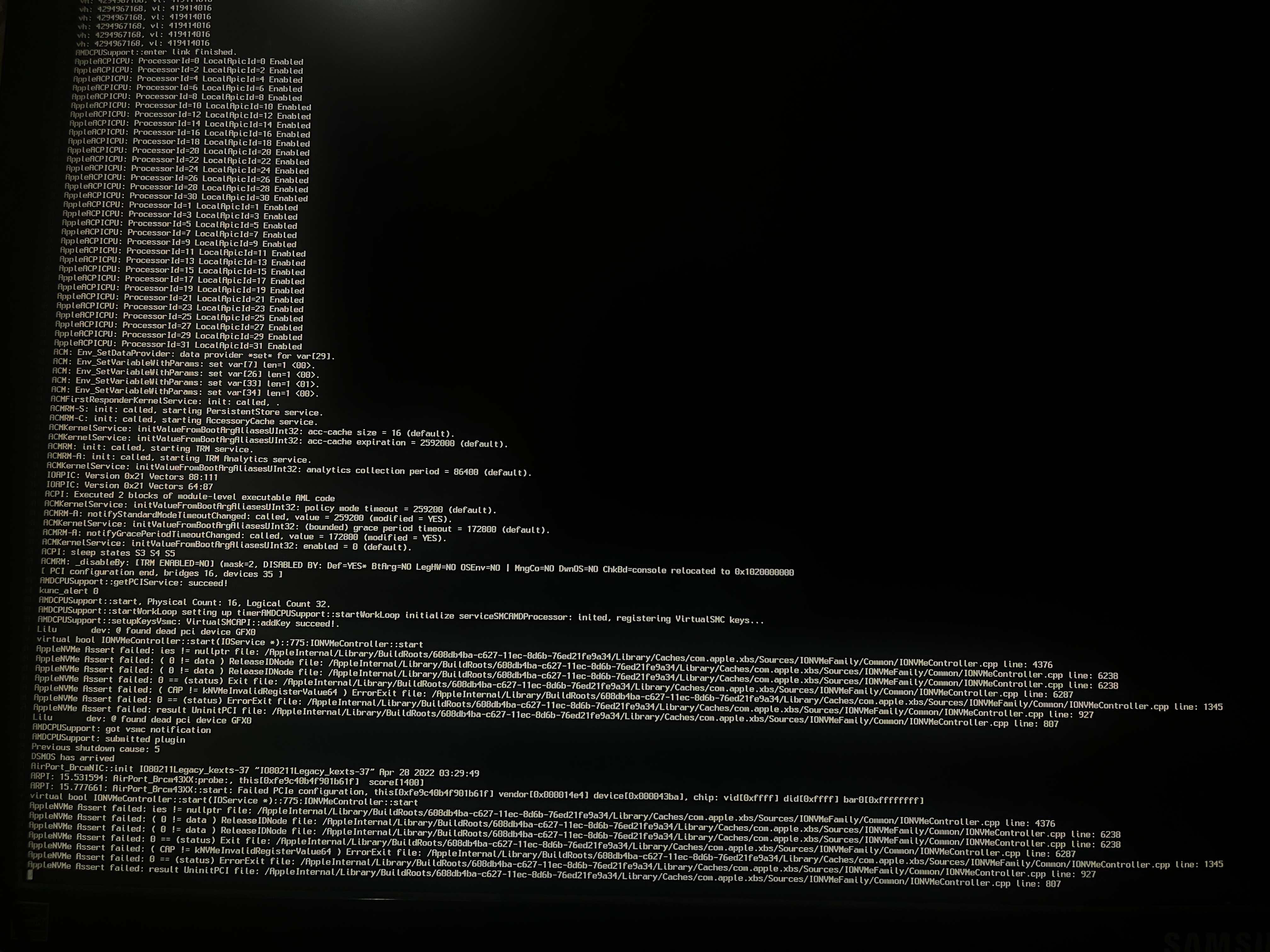

Screenshot of installing to SSD
895
macOS Monterey does not run on MSI 500 boards with BIOS that Zen 3 support.
If you want to use the 5950X with a 6600 XT you either need to use KVM/QEMU to virtualize macOS, or replace the motherboard with an ASUS or Gigabyte.

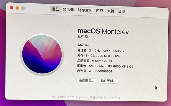

The 6600 XT is only supported by Monterey 12.1 and newer
p2mmao
Jul 2, 2021
43
