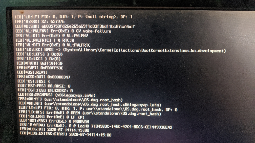

I am getting this error on my FX 8150...some one please guide me.

Please Check this. What am I Missing Here?
  • opencore-2020-07-13-182418.txt
  • Config.plist

Already checked it out and tried all the combinations.
I thought, maybe it is because of the USB stick (Kingston 32GB) but then I put the Catalina installer on it for a test, worked just fine.
I am now testing another USB stick and I will also try to get everything from the latest builds (nightly build etc).
EDIT: installer is working. I physically removed the windows and also the Catalina disk and now I am in the process of installing on a third disk (spare for experiments).
EDIT2: I got it working. Using the latest builds of VirtualSMC.kext, Lilu.kext, WEG.kext and OC 0.60.
