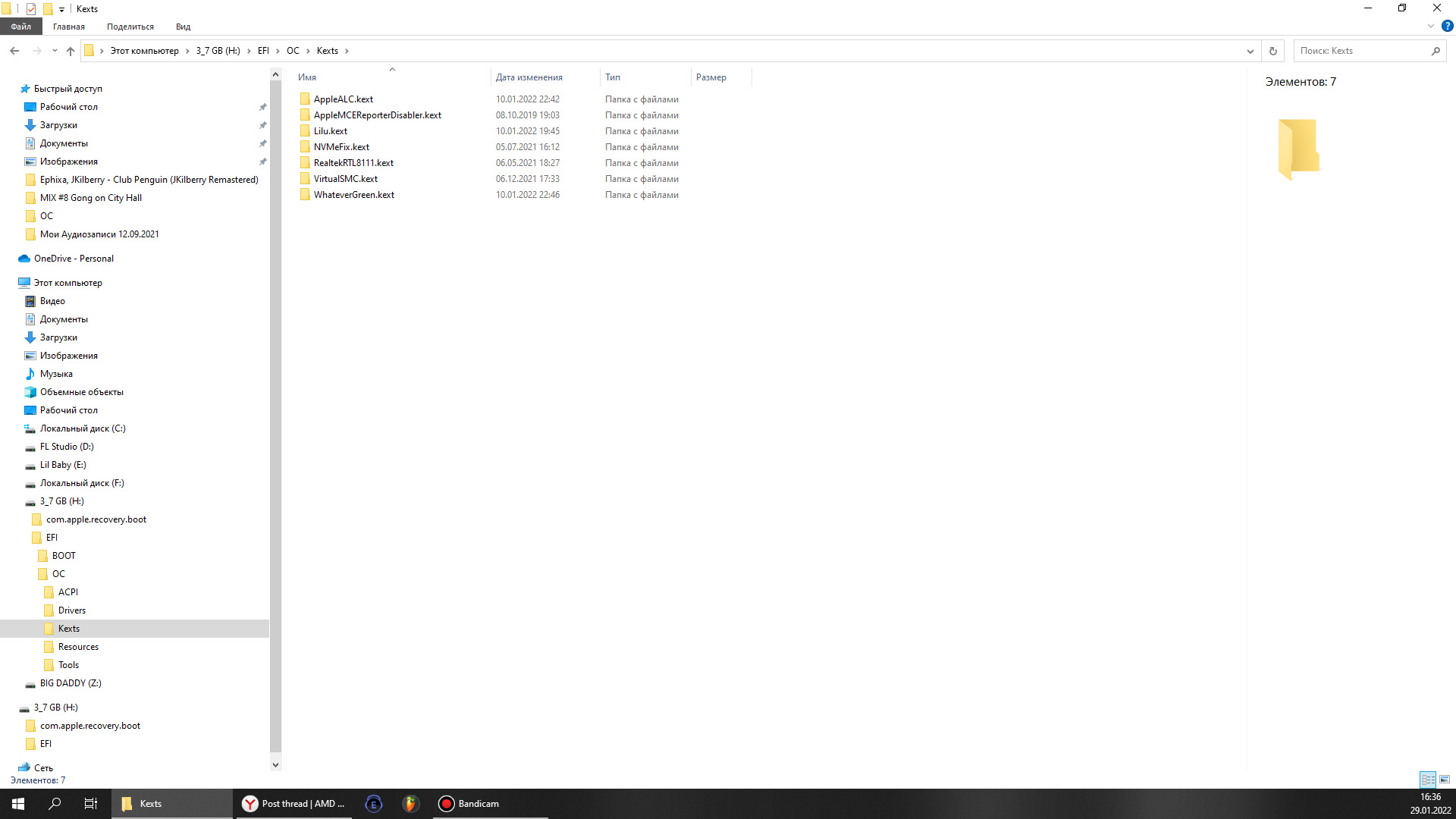

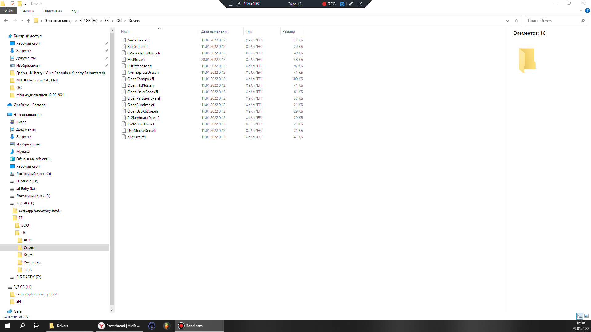

I use OpenCore 0.7.7, done everything by the guide. When I am trying to boot from my USB stick, after a few seconds of black screen I get this report "LoadImage Failed - Unsupported" and installation stops. There is no guide in the internet on this case. Can somebody tell me where it can be fixed please.
I attach my config.plist and screens of kexts and drivers list
