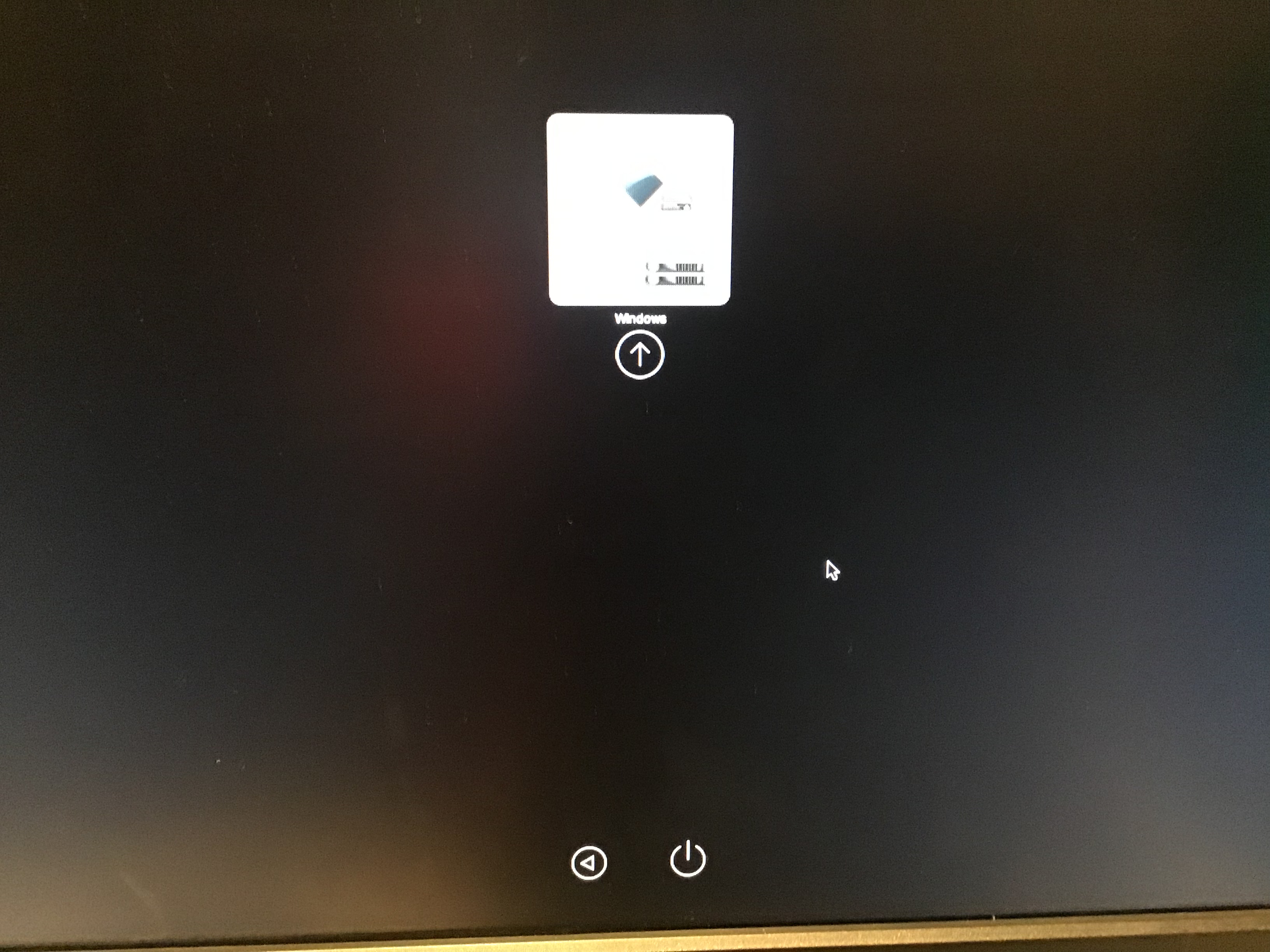

Update,
I have managed to boot but now it only shows Windows
PastEth Man
Jun 30, 2022
I have managed to fix the above but i’m greeted with this
It looks like you won’t be able to go further as you have a Celeron chip installed which is not supported. You need something more like an 8th or 9th gen Intel Core i5, i7 or i9 chip to run macOS. I recommend you should change your CPU first before trying to install it.
