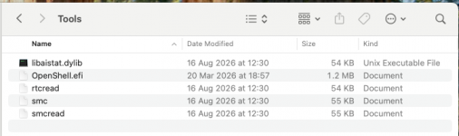

Your /EFI/OC/Tools folder contains a lot of unnecessary files.
All that should be present in this folder is the OpenShell.efi file, all the others are unnecessary and simply taking up space, they have absolutely no bearing on your hack.
Were I creating your OC EFI it would look like this.
Screenshot 2026-08-26 at 22.19.33.png Revised EFI folder contents, with appropriate edits made to the config.plist to match.
