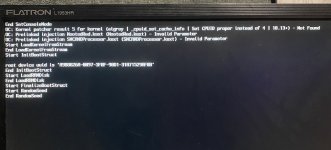

I tried to run the flash drive and this is the result, does anyone know how to solve this?
gpu - gigabyte nvidia rtx 3060
cpu - ryzen 7 5700g
ram - 16g
motherboard - gigabyte b550m

You need to disable/delete NootedRed.kext and SMCAMDProcessor.kext from the OC setup. As these two kexts appear to already be included in the Kernel Cache. Possibly older versions of the same kext were used and added to the Kernel Cache, when the system was running High Sierra.
The AMD Kernel Patch error (top line in the screen image you posted above) was caused by an incorrect entry for that patch.
Try this revised config.plist, which has these three issues resolved as recommended above.
I have also enabled the XhciPortLimit quirk, so your USB ports work when you boot macOS.

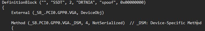

about ssdt-gpu-disable.aml table, when i try boot in macos with enabled ssdt-gpu-disable.aml and it gives me an error, and when I turn it off, it starts, I’ve attached screenshots here, maybe I didn’t configure something correctly?

That IOReg Name PCI0.GPP0.VGA_, looks a bit short for a dGPU in an AMD system. I have a feeling that Windows misses out a section, as it is not named correctly, but rather is named pci-bridge. This is a common issue on AMD systems containing discrete GPUs.
To fix the name you need to generate a custom SSDT using your system DSDT.aml, the Device Path for the dGPU and Corpnewt's SSDTTime script.
Booting the system while using the SSDT-GPU-Disable.aml table with it containing an incorrect IOReg Name for the dGPU will never work. You would be best served removing the incorrect SSDT from your OC setup and clarifying the IOReg Name and Device Path for the NVIDIA GPU in macOS.
