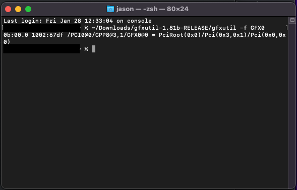

  3. disabled the integrated GPU in the config.plist by following dortania's guide.
Identified integrated GPU:
Disabled in config.plist:

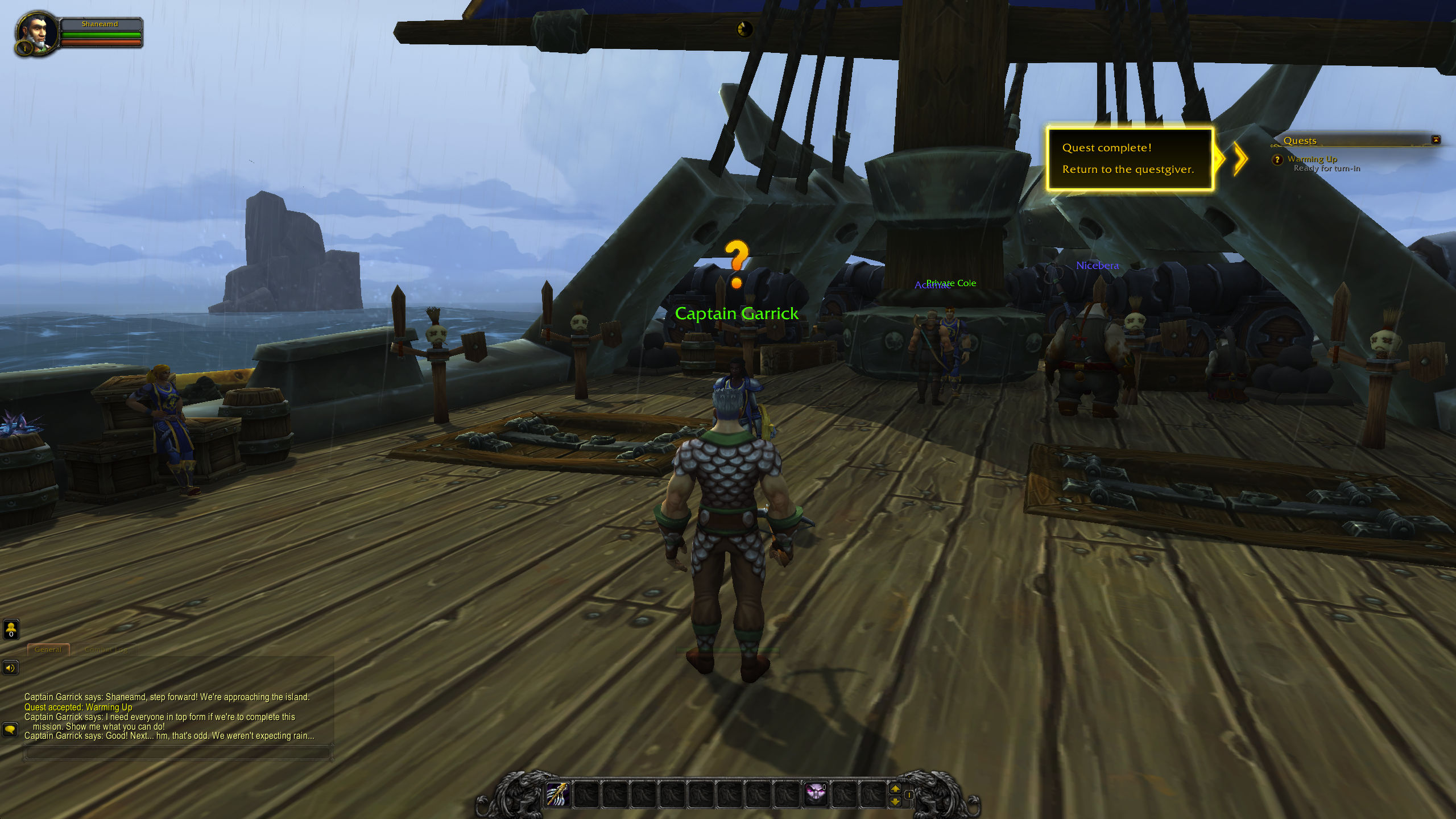

I'd suggest you make a support ticket with Blizard. I thought it was maybe an issue with the game looking for Intel specific instructions but that doesn't seem to be the case. Here it is running on my system. Never played it before 😂
Reactions: tomnic
Working perfectly here too, ASRock X570 Steel Legend, AMD R9 5950X and RX 6900XT: double check your settings. You can try "my" benchmark Xonotic and do a Timedemo to see how it runs
