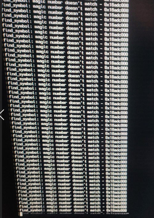

Hello everyone,
I was having the same issue on my Ryzen 5 3600, B450 MOBO, RX 5700 (non-XT) installing Ventura on a new SATA SSD, using opencore 0.8.9. After spending the entire weekend troubleshooting, trying various combinations of kexts and settings, and it turns out that the problem was the OS version. I just got a Monterey .dmg and it boots up just fine, using the exact same EFI.
After, reading this thread, I get the idea that the issue was caused by a recent Ventura update 13.x, right? If that's the case, is there a way of getting a recovery image from a previous version? I was using the macrecovery commands from the Dortania guide and it seems like they only have a command to download the lastest version. I'm quite new to all this, so apologies for any stupid questions.

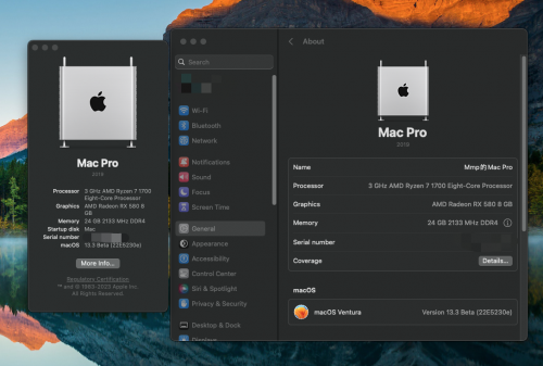

Up and running on the latest beta now.
Thanks for the info and work guys!
Reactions: Shaneee
Thanks guys, Ventura Beta 13.3 up and running.

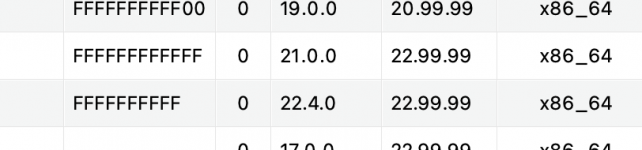

I finally found that to solve this problem is not as simple as adding a line of code, you need to modify other patch codes, I have attached all the patch codes I modified (Opencore 0.9.0)
