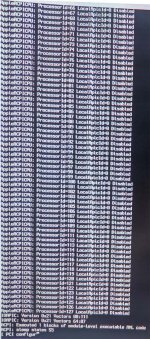

I forgot to put the entry on the ProvideCurrentCpuInfo on true. Now he boots but it doesn't want to run.
Edit
Most restarts come after the [PCI config (Picture 2)
