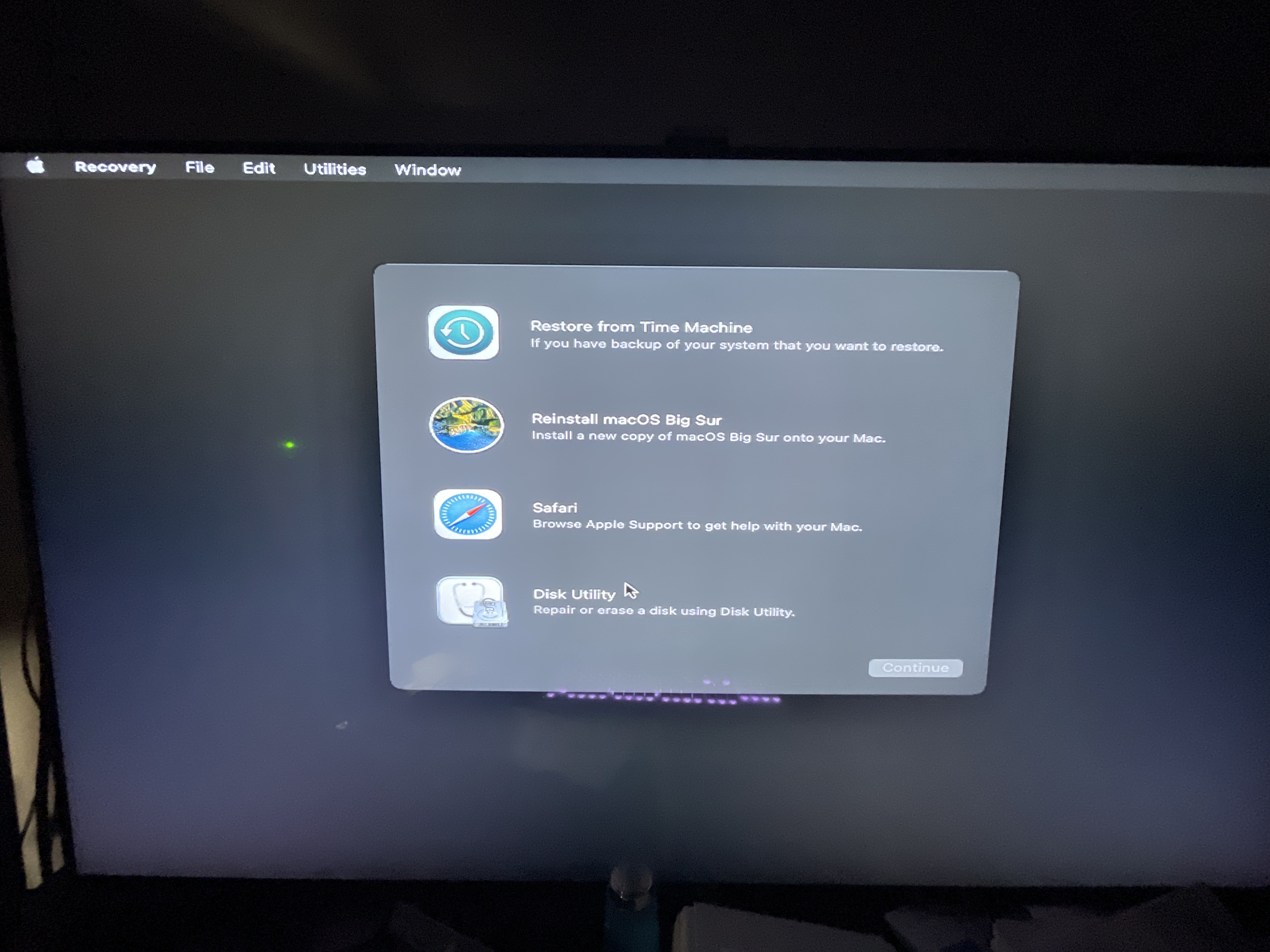

Seems like something is booting now, I changed the driver of "hfsplus.efi" to "hfspluslegacy.efi", and not something booted and asked me to hit enter for "(external) dmg", which I did so and now I get a blank screen and computer is restarts and goes through a loop process. I also updated the log file below.
I get the above screen, when I click on "boot (external) dmg", I get few texts of lines then the computer goes into a complete blank screen, then the computer restarts into a loop and goes back into the same menu.
Followed all the steps from the OpenCore guide for AMD build.
What going wrong here?

Edit, I solved the problem, here is the link how I solved it:
https://www.reddit.com/r/hackintosh/comments/orugi6
