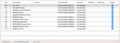

Finally, GPU and USB has fixed. At first, I tried the Dortania USB guide but unfortunately, maybe I messed up and made a wrong USB-map.kext(which work with 1USB port). Later on, tried with the Hackintool, and made a USBPort.kext. It works as expected, and Bluetooth automatically works after sleep.
Again, I've attached the IOReg file, Kext and OC kext(ss).
Thank You a lot @Edhawk
*Without AppleMCEReporterDisabler.kext System won't boot (MacPro7,1 smbios).
