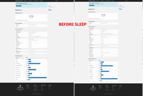

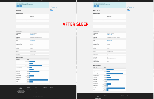

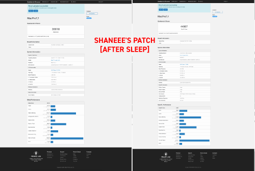

I tried with your EFI folder, here is the result:
Still no improvement, but a Massive improvement after sleep.
Before sleep:
After sleep:
2,393
Yeah, big improvement after sleep on the Metal side in particular. Looks like you need to force your system to sleep just to get the better GPU processing.

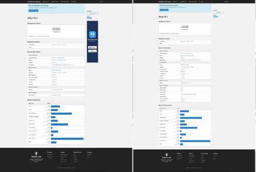

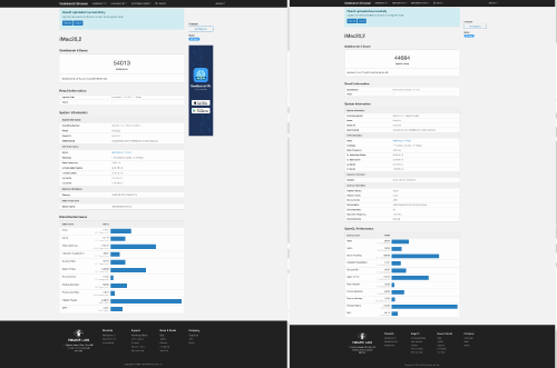

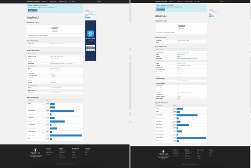

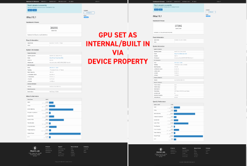

Thank you both for your support, As @craighazan says, I switched my smbios to iMac 19,1 & npci=0x3000, and GPU Performance finally fixed. Also, I've tried some other smbios to test. Here's the result:
iMac19,1 (Currently, I have switched to this smbios)-
iMac19,1 (GPU set as Internal/Built-in via Device Property, Otherwise In Adobe Media Encoder it disables Hardware encoding although it's using GPU when rendering anyway)
iMac20,2 -
iMacPro1.1 -

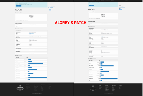

AMD Polaris GPUs with a MacPro7,1 or iMacPro1,1 SMBIOS have bad performance, you'll need to use one like iMac20,2 but keep in mind that you won't have hardware encoding/decoding or DRM. You could also try injecting a framebuffer and removing WhateverGreen.

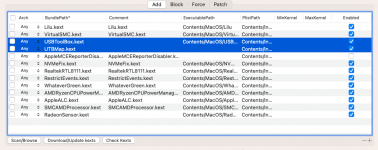

I created UTBMap.kext (from Windows) and installed it, but it's still the same, I have to turn bluetooth off and on. Anyway, No big deal.
Thank You
2,393
Why do you have AppleMCEReporterDisbler.kext - Disabled in your OC config.plist? Surely you need this for your AMD system to boot.
Try removing/disabling the RadeonSensor.kext.
Make sure you use the ResetNvram.efi tool after enabling and disabling the two kexts, so the new settings are used when you boot your system, not your current settings.
Post a copy of your new UTBMap.kext, so we can see what you are using now.
Thank You
Did you set the Bluetooth port as Internal? Send the map and an IOReg dump.

Okay I'll disable AppleMCEReporterDisbler.kext, and I use RadeonSensor.kext to monitor GPU temp anyway I'll also disable it while testing.
Here are UTBMap.kext and IOReg.
