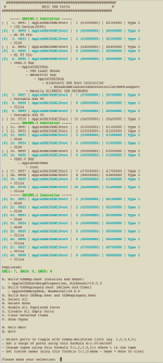

Here an overview of the ports
Port 6 needs to be changed to 255 (internal), as the two front case USB2 ports and Bluetooth module are served by the two internal header ports.
Other than that one change the rest looks really good(y)

This is the port configuration I currently have:
