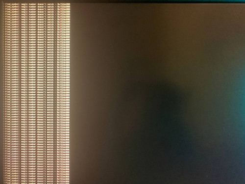

I test with other usb 2.0 pendrive with macOS Ventura, and no boot, run macos installer and after some text show me this all time
find_symbol: magic number doesn´t match 0x152dc000

Did you update patches? you should you latest patches
Do you use AMDRyzenCPUPowerManagement/SMCAMDProcessor? update it - there was bug in the kext
I have lastest updates all kexts.
You don't. Old versions of AMDRyzenCPUPowerManagement used the __PRELINK_TEXT kernel header which wasn't working anymore in macOS Ventura. That's why that error happens, it cannot hook into the kernel. This was fixed by changing __PRELINK_TEXT to __TEXT_EXEC which actually works on macOS Ventura. Double check your kext versions.

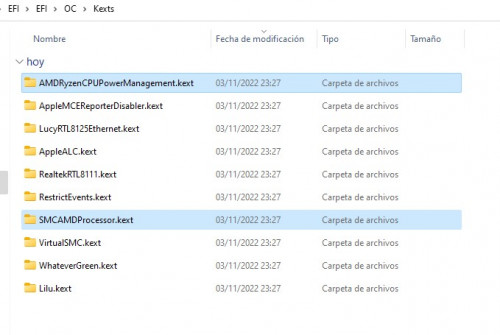

Is this the last version? https://github.com/trulyspinach/SMCAMDProcessor/releases/tag/0.7.1
With AMDRyzenzCPUPowerManagement.kext latest update, reboot when I try boot macOS Install

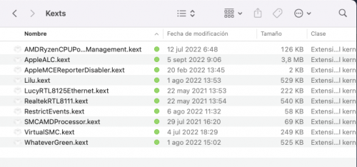

Did you try latest AMDRyzenzCPUPowerManagement & SMCAMDProcessor kexts?
Yes, I try with latest kext.
Also I test without this 2 kext and same issue, reboot.
Can I change boot args with macOS Install?
