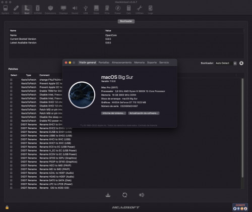

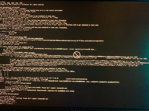

I updated my EFI to OC 0.8.5 and works with Big Sur, but when I try to install from pendrive macOS Ventura, boot and freeze with this cross.
I have MSI B550 Tomahawk + Nvidia GT710 with Samsung 970 Evo (Windows 10) and Samsung 850 Evo (macOS Ventura) and bios updated for Ryzen 5000. Can any help me if it is possible install Ventura or update to Monterey with this curse motherboard?
2,013
The error you are facing is ‘still waiting for root device’. This is common when the USB installer is dropped by the OS after control has been handed over to the OS from the bios.
You should try using a different USB port in the first instance.
The better solution is to map your USB ports in Catalina, so they work without issue in macOS.

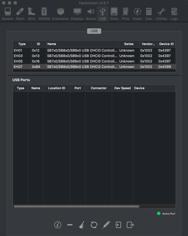

I test with different ports, front and rear of the case and motherboard.
How can map my usb ports? All works with macOS Big Sur, I can use any of this, also I can boot macOS Big Sur with this pendrive, but if I try boot macOS Installer has issue with USBXHCI I understand. I test with Samdisk Extreme 16GB usb 3.0, I can test with other Toshiba 32GB usb 2.0 better.
Need modify something on bios? I have MSI B550 Tomahawk motherboard, and dortania guide recommended ony Big Sur, and I can update to Monterey or install Ventura.
