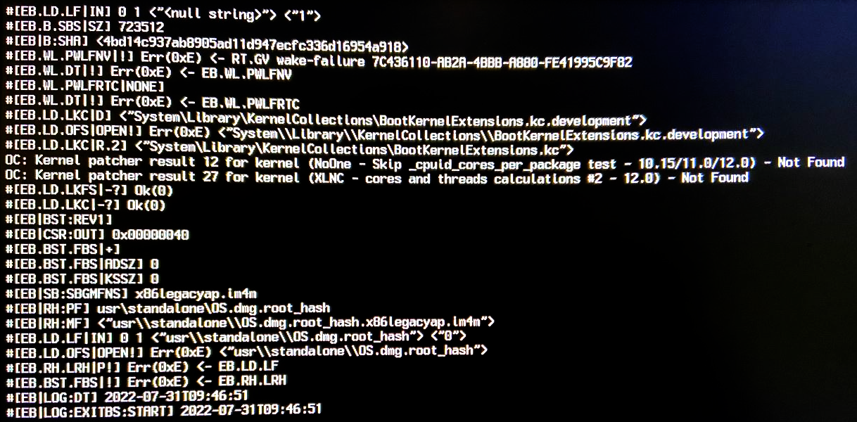

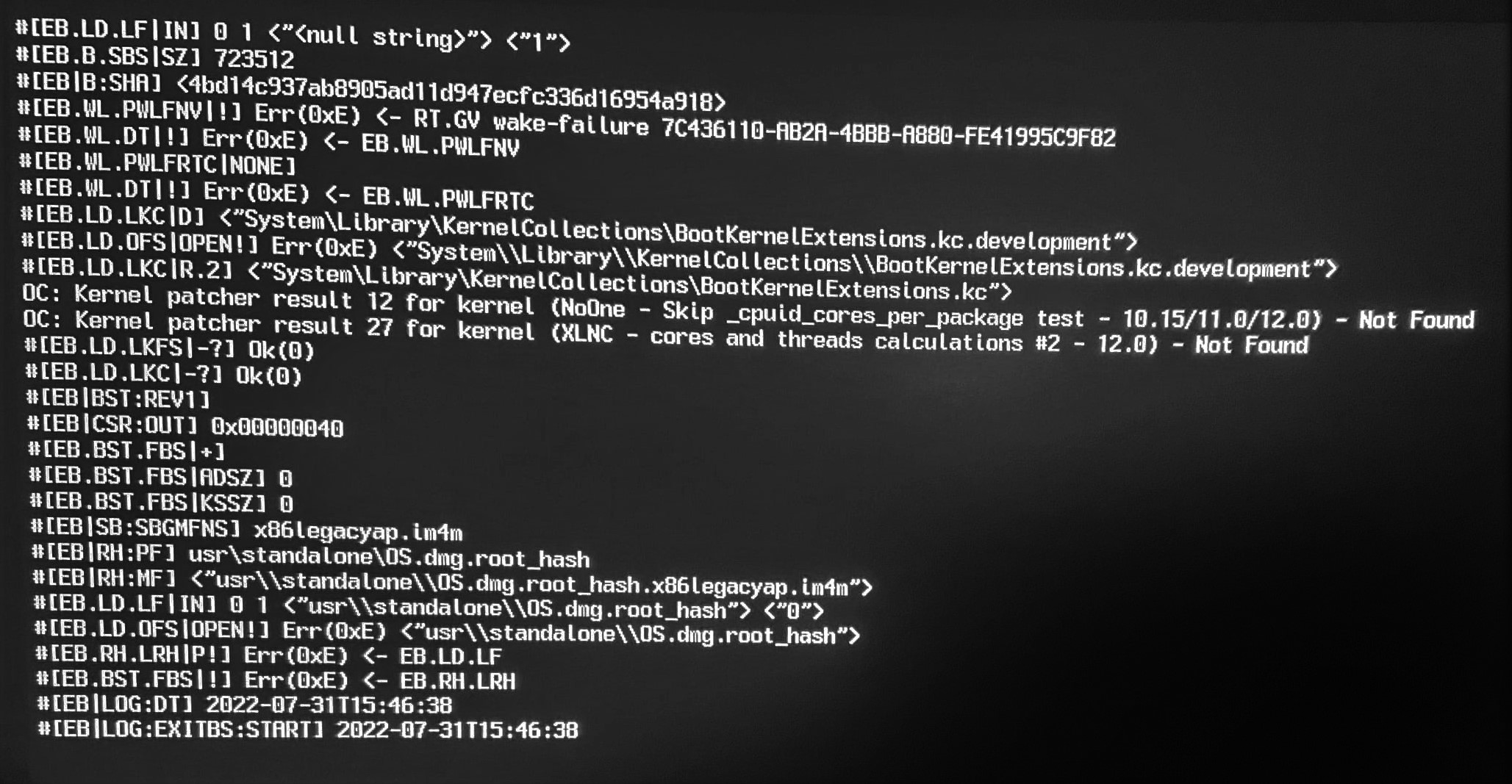

Hi guys!
I stuck at boot install Monterey 12.5 (21G72)
I use OpenCore 7.8 (updated from 7.1 at OCAuxillaryTools), AppleMCEReporterDisabler added, all BIOS settings is correct (BigSur work perfect). I try MacPro7,1 and MacPro1,1 SMBIOS and do same problem.
I've been sitting with this problem for a week now, using different EFIs of people from this forum, but the result is still zero.
I think problem is my bad OpenCore update or missing kernel patches.
Can you please help me?

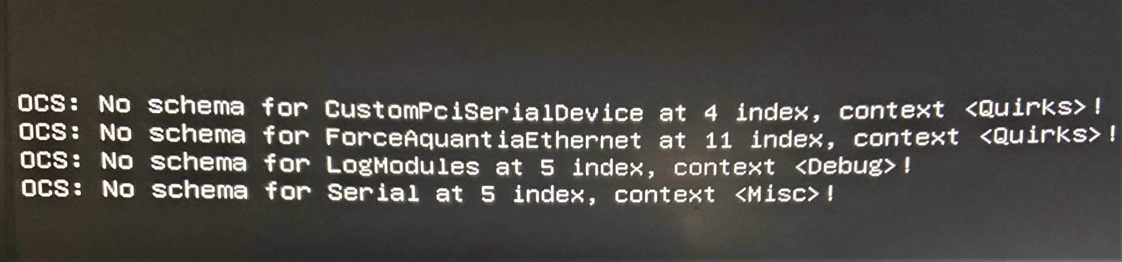

Thanks but this EFI doesn't work for me
I got the same errors and additional "No schema"
2,357
You need to check to see if you are using the correct config.plist, as all those entries are present and correct in the config.plist I provided in post #4.

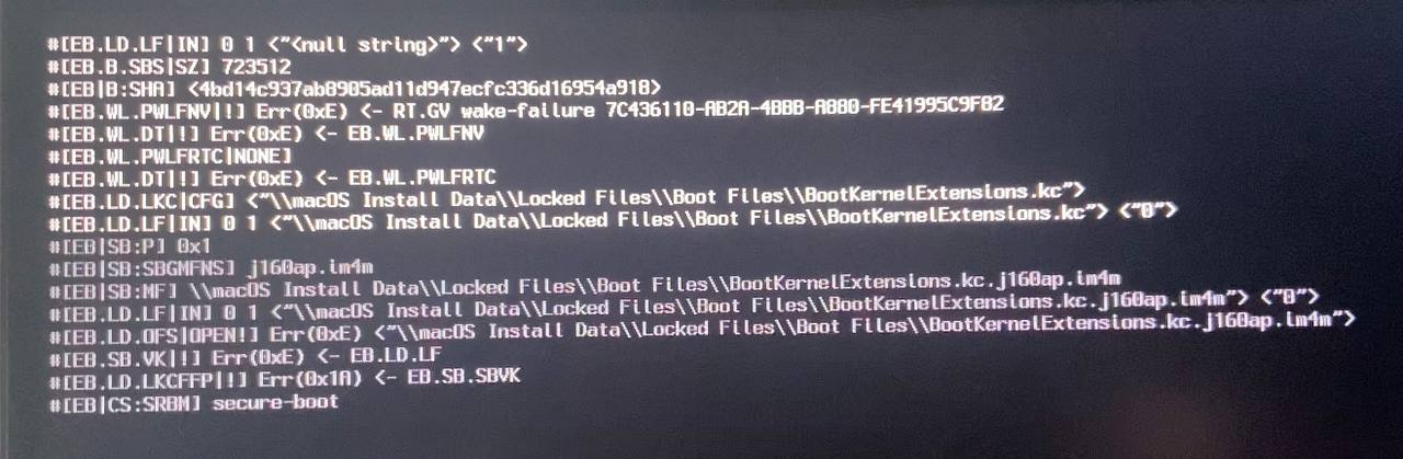

Oh sorry, I'm using the wrong folder. Now I use your folder (thank you very much for it!) and get a boot loop after the first Monterey restart.
I recorded a video and attached a screenshot of the error that appears for a split second. Secure boot is disabled in bios, NVRAM was resetted.

I changed securebootmodel from "default" to "j160", nothing happened, but when i set it to "disabled", i can sucefull install Monterey after 5-6 reboots. Is it stable?
2,357
Default, is the correct setting for SecureBootModel when using a T2 SMBIOS, i.e. iMacPro1,1 or MacPro7,1.
Yes it should be stable, once you have done your part.
You do know that installing macOS is only the start of the journey, don't you? Especially when hacking an AMD system.
You now need to look at the Post-Installation processes to make the system stable.
