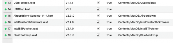

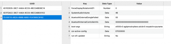

Check the modifications I made to this users config under NVRAM for Intel BT to work and copy the two to your config,
JohnFante
Nov 18, 2023
25
2,180
Try cleaning NVRAM since that's what we are adjusting here. Just to make sure they are correctly injected. Also in your USB Map make sure that the port where BT is connected to is marked as Internal.

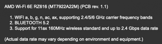

I have found my issue. 😖
Checked my motherboard and it is an rev 1.1 of the Gigabyte X670E Aorus Master and that does not have the Intel WIFI/Bluetooth but the AMD Wi-Fi 6E RZ616 ...
If you know of a kext for that please let me know ... for f... sake how did I miss that.
2,180
Ahh that won't help. The AMD WiFi uses MediaTek which isn't supported in macOS. It should be possible to swap it for an AX200 or AX210 though.

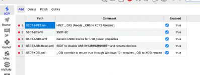

I would question where you obtained the ACPI tables in your EFI.
  1. AM5-UOI-F.aml - appears to be a DSDT.aml table that has been renamed.
  2. SSDT-Basic-AM5.aml - contains fixes that are also present in other SSDT's you have enabled in your config.plist. These include SSDT-CPUR.aml (CPU processor settings), SSDT-USB-BAZ.aml (USB power settings) SSDT-HKIN-RX.aml (SSDT-HPET.aml no patches)
  3. You are lacking a number of ACPI patches, for the fixes applied in these SSDT's, which usually means the fixes (HPET_CRS for example) won't work. As the two parts are required to enable the IRQ resource fix.
Personally unless you know these SSDT's came from a system that is exactly the same in every way to your own, I wouldn't use them.
I have generated some custom SSDT's using your system DSDT.aml table and Corpnewt's SSDTTime python script. These and the accompanying ACPI patches can be found in the Results folder attached below. It also contains a DSDT-Patched.aml that includes some specific fixes that are required for a gigabyte AM5 board.
You have HfsPlus.efi and OpenHfsPlus.efi present in your Drivers folder. You don't need both. Remove OpenHfsPlus.efi as HfsPlus.efi is the better driver.
Your system doesn't need help to Emulate NVRAM, so you don't need OpenVariableRuntimeDxe.efi Driver in your OpenCore setup.
As @shanee wrote, your MediaTek WiFi/BT card isn't supported in macOS, as there are no third-party kexts for the series of WiFi/BT card your system uses.
I would recommend purchasing an Intel AX200NGW WiFi/BT card and replacing the MediaTek card, as it is not a given that the Asus BT-400 (Bluetooth USB Dongle) will work in Sonoma.

Just to be clear: Basically I remove the aml files etc. in the ACPI section (via OC Auxillary Tool - see below) and add the ones you so generously have supplied (drag and drop?)? And ofcourse reset NVRAM.
Sorry if this is a noob question but I have not much experience tinkering with OpenCore .... as you probably have figured out by now :)
