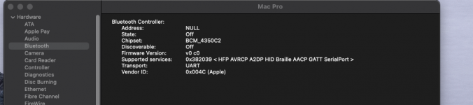

However, the issue is bluetooth. I have a Fenvi T919. I've never been able to get bluetooth working on it, to be honest, not even in Windows (maybe bad card? Wifi works in Windows and Mac). Sooo many late night readings, and trying this and that. Supposedly no kexts needed for the Fenvi, but I've tried a lot of things, ending up with the BlueToolFixup, BcrmPatchRAM3 (and tried 2), and BcrmFirmwareData. Always this when I run hardware report.
I see this a lot across a lot of different forums. So thought I was getting somewhere. Today, I removed my Fenvi T919 card completely. Rebooted and I've run Nvram reset a few times now.
The funny thing is when I run the hardware report, the above picture persists. How can that be? There isn't even a bluetoothcard in my PC at the moment. I'm using the MacPro7,1 as my model. Is it because of that? And is that even the correct model? (it works so I stuck with it).

I thought the picture above was interesting, as maybe it is what it defaults to if no bluetooth device in your PC at all. Or maybe some other reason that escapes me.

Frustrating for sure, FYI bluetooth and sleep/ wake behavior require proper USB Mapping. Without that what you describe is the usual consequence. The reason the Bluetooth Dongle works where the Fenvi wouldn't is most likely because the internal USB header you are trying to connect to isn't properly identified. The USB port the dongle is plugged into is functioning on some level and so bluetooth works.
It's a very, very common issue so rest assured you are not alone in trying to sort it out. By example I see you have only one internal port (255) identified in your USB Map, there are at least two. One for whatever internal USB header for the Fenvi card and the other for the RGB Controller.
Up to you what you want to take on but I know if it was me I'd go back to the drawing board and use USBToolBox in Windows and go through the same process you probably already went through once. Search Github for USBToolBox if you aren't familiar with the app.

I would check out this thread here being he's using the same board and went through hoops figuring out USB

Hey leesurone,
Thanks for the information. I'll check it out. Really appreciate you taking a peek.
I'm having better success, at least with the shutdown/sleep stuff. The only thing that still is weird is if I leave a USB thumb drive in and pull it out after shutdown, the computer restarts. But, I'm really thinking, probably like you, it's all USB mapping related. So, got to get that USB mapping part nailed. But in general it's all pretty stable now, so can't complain too much.
