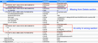

thank you it works better but I have this at startup
maybe a graphics problem?

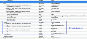

Means you have an unnecessary entry in your config.plist in the NVRAM section, under that number. You can delete it from your config.plist to remove this message.
You are missing a section under the NVRAM > Delete options, one that is present in the Add section above, see screenshot from your config.
Screenshot 2024-04-03 at 20.41.30.png current NVRAM > Add & Delete sections with incorrect entries.
Screenshot 2024-04-03 at 20.46.35.png revised NVRAM > Add & Delete sections with corrected entries.
Revised config.plist containing correct NVRAM entries is attached.

thank you it's great
no more unwanted restarts
