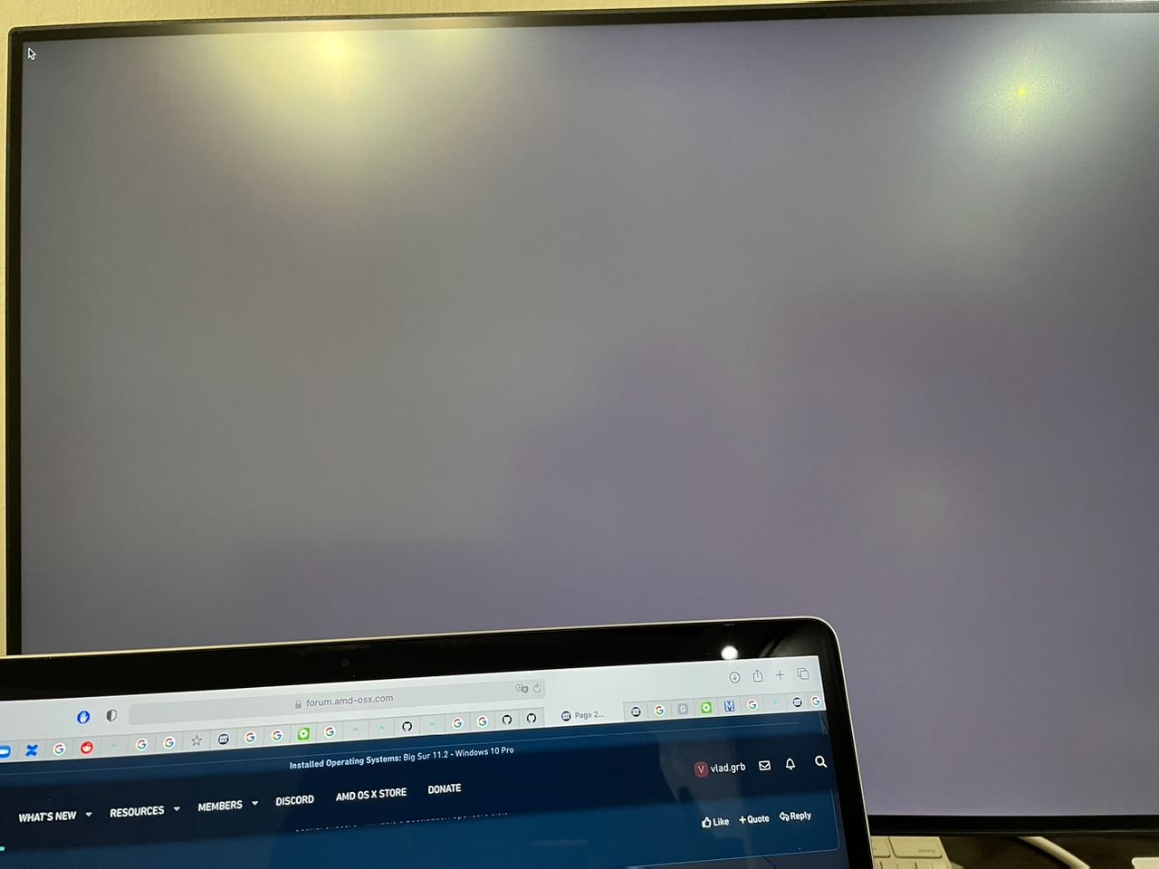

Hey there!
I was inspired to try a such build but seems misunderstand or missed something important.
Mobo: Aorus x570 Pro rev 1.2
Bios: f33g
Video: Sapphire rx580 8gb
CPU: 5800x
NVME m.2 Evo 970
I pulled the archive and added platformInfo from genBios.
When select Install Big Sur I get Apple logo with progress indicator for 10-20 secs and then grey screen with mouse moving appear where should be the window with an installation process like language selection, but it is missing as top menu bar with Utilities, etc.
Googling doesn’t help. Sounds like I have to make something regarding the ACPI. Any guiding would be helpful. Thanks.

4g is disabled and all BIOS settings are adjusted from Dortania's guide as well.
I even tried Big Sur 11.2.1 but the result is the same. Definitely I am missing something.
Probably your wise look could see the issue
1. Added Platform Information from GenSMBIOS(used iMac19,1)
2. Added ROM generated from the internet and entered as Data field(between <> angles).
3. Removed agdpmod=pikera from boot-args
Still no luck.
Does the log help to diagnose the issue? I don't believe that GPU is the cause because it works like a charm for my previous Catalina try with MSI board.
I am not that much experienced. Hope that number of ssd/hdd or m.2 inserted doesn't make difference for the install and in general doesn't affect the process. Since I am using only 1 NVME m.2 slot.
Update:
If I do not disconnect mouse and keyboard then the screen is black. Once I connect them I see a flick with Mac menu on the top and then the screen becomes grey.

1. Generated SMBios values for iMacPro1,1.
2. Took mac address from mobo's BIOS from network menu and put it to ROM(just numbers).
3. Double checked from the first page BIOS settings. All are ok.
4. Double checked agdpmod=pikera is removed from boot args.
Still the black/grey screen :(

After NVRAM reset the same thing happens to me mate. Only single monitor is connected during the installer's launch.
I created the usb installer from Mac OS using "modern" way with python script from OC guide with 11.2.3 Big Sur version.
I tried the old usb stick for MSI board and was able to get to the restore window where it was saying that "Couldn't start install with the stack trace". But Big Sur rejected to work.
I noticed one issue that after logo appears the progress is moving but at some point it flickers one time and progress is frozen. When trying Catalina stick do not face this issue. Looks like some patch is weird.
Shall I make a debug EFI and share the OC log? May be it could help.
Appreciate your suggestions. Thanks a lot!

I took another USB(2.0) and burned Bug Sur again. Now the issue is a bit different, the logo appears, but the progress indicator doesn't appear.
So then I took your EFI(with previous adjustments for Platform and boot-args) and turned on the verbose mode(AppleDebug, Target to 67, replaced the OC files openCore.efi, bootx64.efi and tools with debug version) I attach the log and the result where it freezes.
