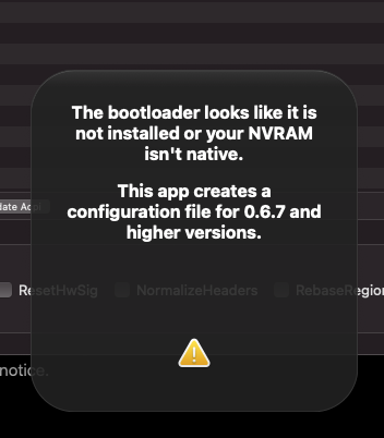

@AudioGod I have some problem here. Hackintool don't recognize open core. Opencore Configurator give me error attached. System boot normally, but not shutdown. When I shutdown system power off completely, but restart alone after 2-3 second.

In the config.plist under misc -> security Change ExsposeSensitiveData from 7 to 6 and do not use hackintool to configure opencore. This is a bad move. my EFI is already configured just add your details and do it with plist pro or Xcode or Evan proppertree.
Dont try to configure your usb with hackitintool either use the following script to do it with.
