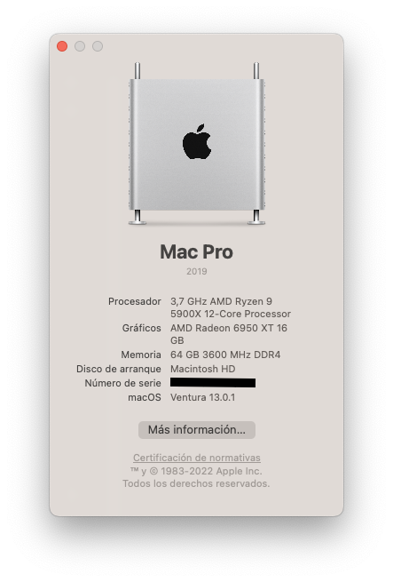

Thanks so much. Everything is Ok but I have problem with shutdown/power off. When I try to power off every times I have to wait for 1 min and then is a restart not shutdown/power off. Do you know how to fix it?? Thanks in advance. ( excuse me my poor english) .
lukakeiton
Jul 26, 2020
87
Can you post your EFI? With your info, I can't do anything.

Thanks so much Lukakeiton, I have your efi ( without modification ). My computer is the same as yours, except for the graphics card ( 6800XT). The same motherboard, the same cpu, the same memory but I have a multiple usb controller.
Here is my efi.
Everything work Ok but I only have problems with shutdown. Thanks in advance. ( and excuse me for my poor english).
Here is my efi.
Try removing the multiple usb controller.
