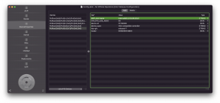

In my device properties I tried referencing my GPU and the behavior is the same, on the arguments in boot-arg in the same way I tried with agdpmod=pikera and agdpmod=ignore, I still get the same result.

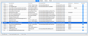

I tried making some changes with my configuration in your EFI, I only got the CMOS not to lock but it restarts when it wakes up from the second sleep, I enclose my PCI data in case I made any value that is not correct.
In your config.plist in Kernel this name LucyRTL8125Ethernet.kext is wrong, it must be SmallTree-Intel-211-82576.kext, that at startup caused the boot to fail.
Remove from DeviceProperties the reference to WIFI since it stopped working, I use Fenvi FV-HB1200

Also about the LucyRTL8125Ethernet.kext that was actually already present in the config.plist you first gave me, hence why I had it enabled. But I did find it strange at first.

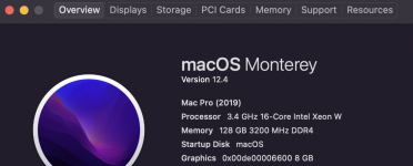

Thanks for your time and help @Middleman, I tried with your EFI in CPU it keeps showing me Xeon, the ethernet connection failed to work, USBInjectall fails to enable all ports, before this I added my GPU data in DevicePropertes to my original config.plist that you provided, with that I have black screen for about 20 to 30 seconds at startup, at the end of that everything works fine, I no longer have the CMOS hang problem after the second sleep.

Hi @jarley91,
a) Okay, for the Xeon CPU showing, try this. Go to PlatformInfo > UpdateSMBIOSMode and change it to Create.

As for the Opencore guide not having the GPU details well Opencore doesn't document everything we do (or need to do) to get the machines running.
Sometimes to boot the OS properly it is preferable to have a populated device property tree than not. I experienced that yesterday just trying to boot
another 11th gen machine.

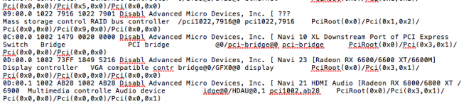

c) As for the RX6800 details, it was this (only minor issue I see, is audio related)
Btw you need to change the DATA type for the model to STRING and then type in Radeon RX 6600 as that looks corrupted.

Hi @jarley91,

About Radeon RX 6800 XT, from the beginning I noticed it in the PCI list, but I assumed that it loads the driver for audio with that reference, now I assume that it is normal and that I do not have audio problems in my monitors, by the way I use 3 in 4k and all is well.
