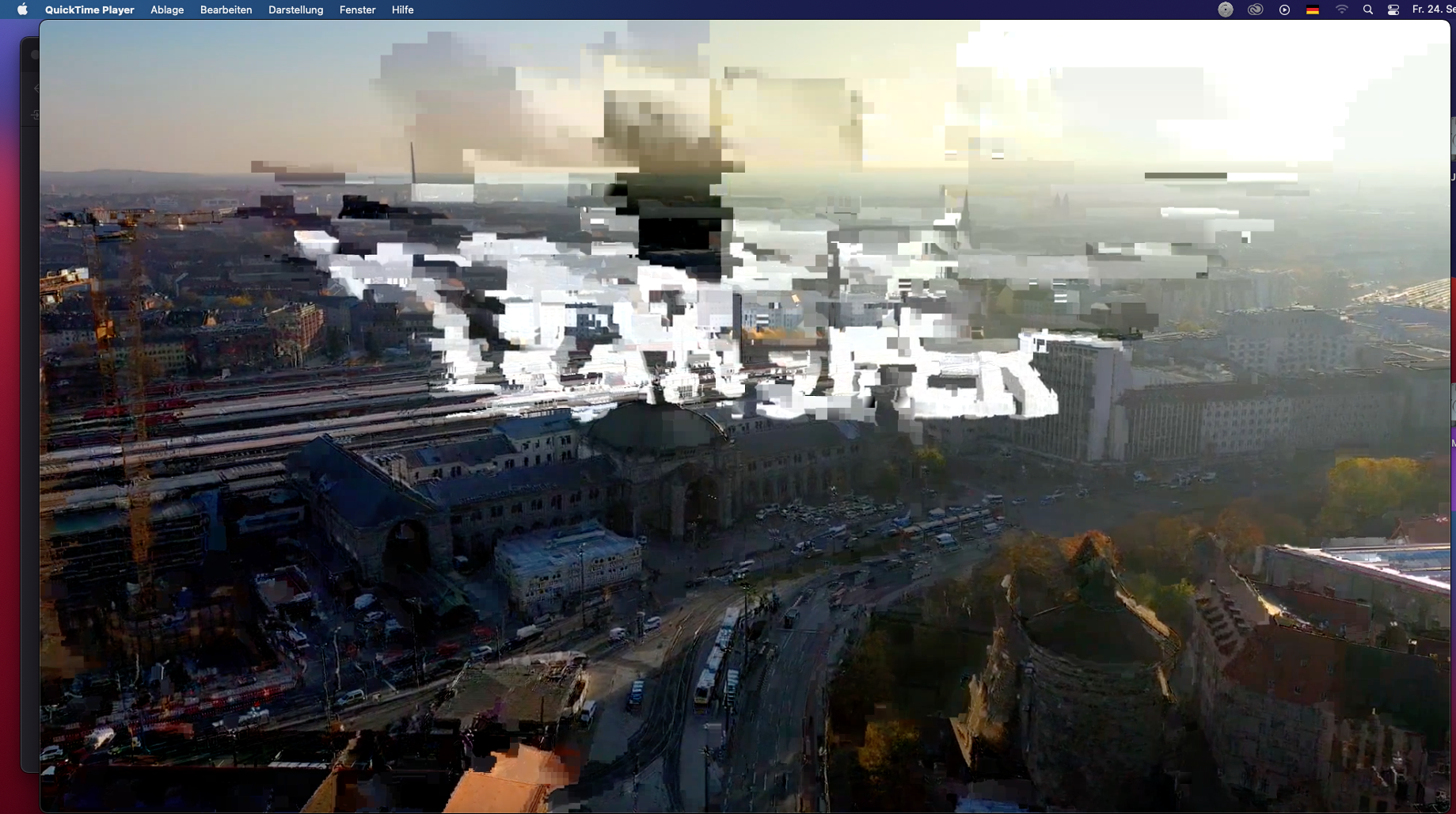

Hi,
I have a problem with my hackmac. The video playback shows always compression errors. In all video app (QT, VLC). Also in Final Cut the play is wrong.
In browsers, youtube playback works without problems.

Hi,

Nasty, I use VLC on a daily basis and have never experienced anything like that.
Could be your setup or your Config. I’m not on my main system to check your Config.plist but try disabling WhateverGreen and removing any WEG related boot arguments And try it that way. (Do it on a usb installer instead of your main drive so if it goes wrong without WEG you can revert it with ease)
i have been rocking a 6900 XT and a 6800 with and without WEG and Big Navi GPUs definitely seems to like working without the kext more.
I ran into green screen AppleTV problem without WEG, but I can live with it. Disabling WEG see noticeable improvement in graphic performance.
I can confirm indeed XFX 6900XT bios doesn't play well at all. Switching to a reference edition eliminates all small graphical problems I have
I’m surprised you have any DRM issues without WEG. I have tested everything I can think of DRM wise with a clean sweep across the board.
I'm surprised myself too! Perhaps that's my monitor. Will order a few more to test. Never run into any DRM issue before with hackintosh

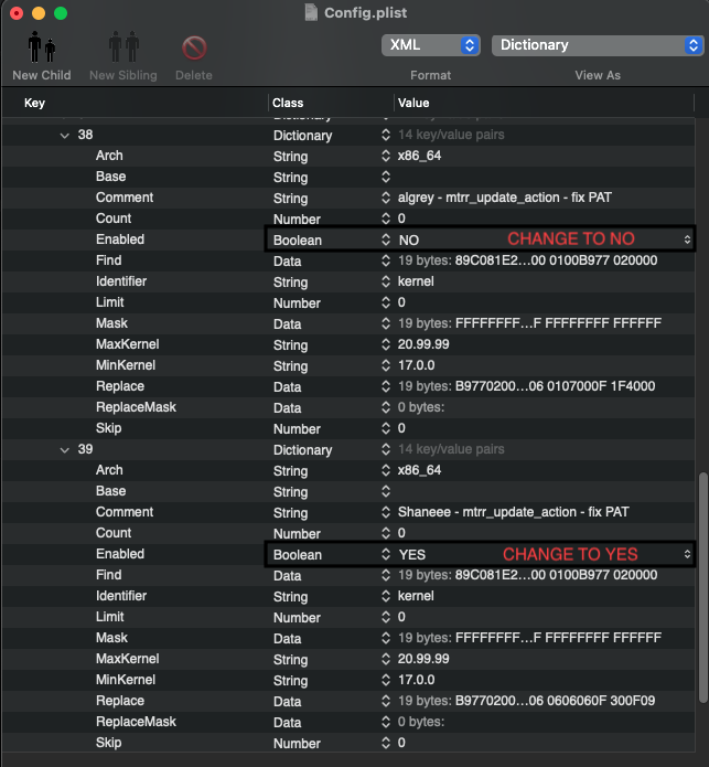

ok after 3 days of trying to get my pc to run the macOS I've finally got it thanks to this forum, I've 2 maybe 3 issue I need help with lol.
1, ive no sound coming over my GeForce GTX 1080Ti 11Gpbs card.
2 ive no Bluetooth or WiFi just lan
3 when I'm opening images and videos up the system hangs a bit.
is the 3 issues above just a matter of install the kexts files or do I also need to edit the .plist ?
TIA pod
is the 3 issues above just a matter of install the karts files or do I also need to edit the .plist ?
TIA pod
1. Go into the config.plist and under Kernel -> Patches scroll down to the very last patch and disable it followed by enabling the patch directly above it.
(Do the reverse of what the example is showing)
Note - the GTX 1080ti is not compatible with any versions of MacOS other then High Sierra.
