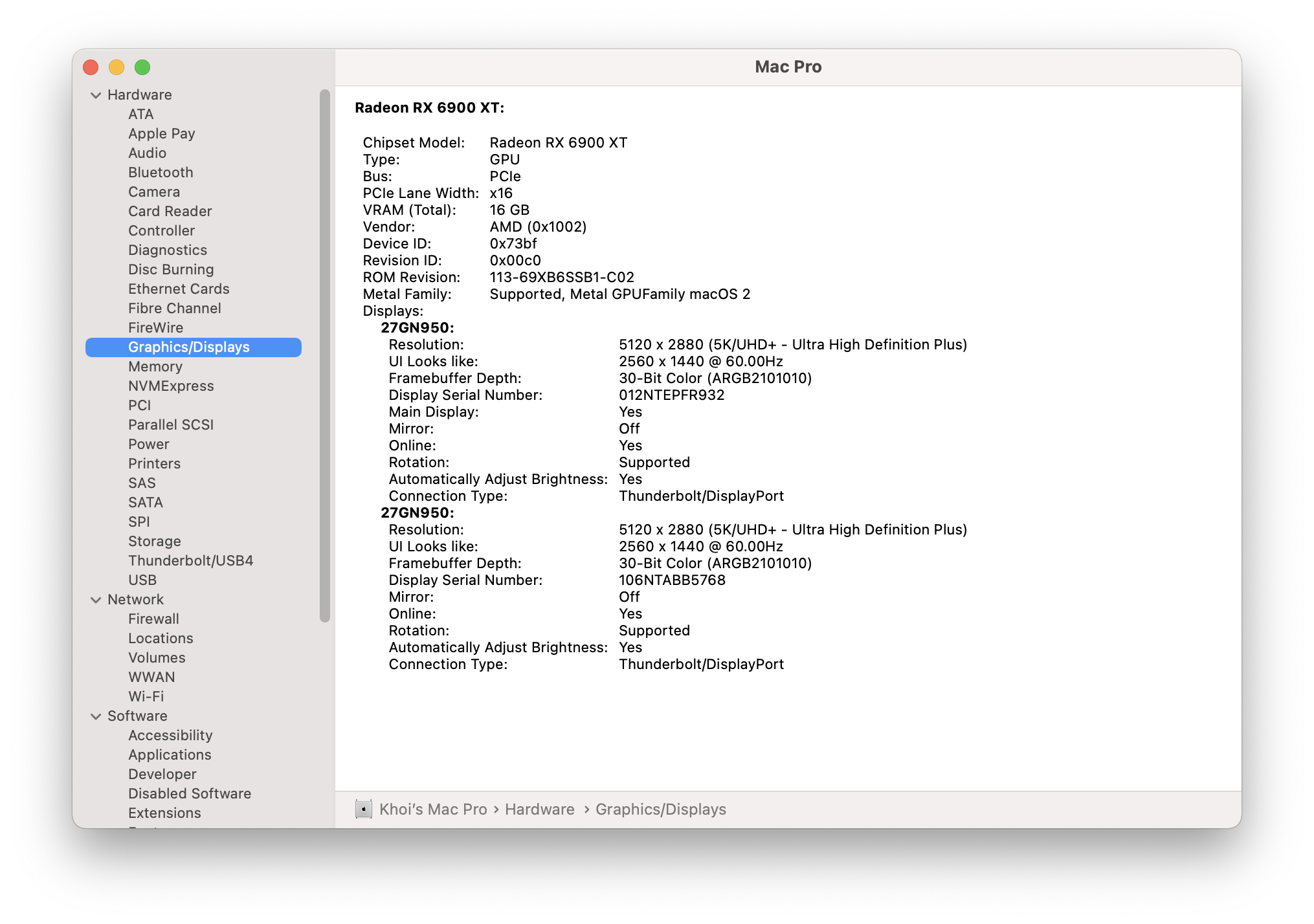

I'm using a pair of LG 27GN950 that has DP DSC, I can't seem to get the DSC to work so I'm stuck in 60hz at 4K, is it Big Sur issue? I was able to get DSC with my M1 on Big Sur, so it must be something not right with my config.

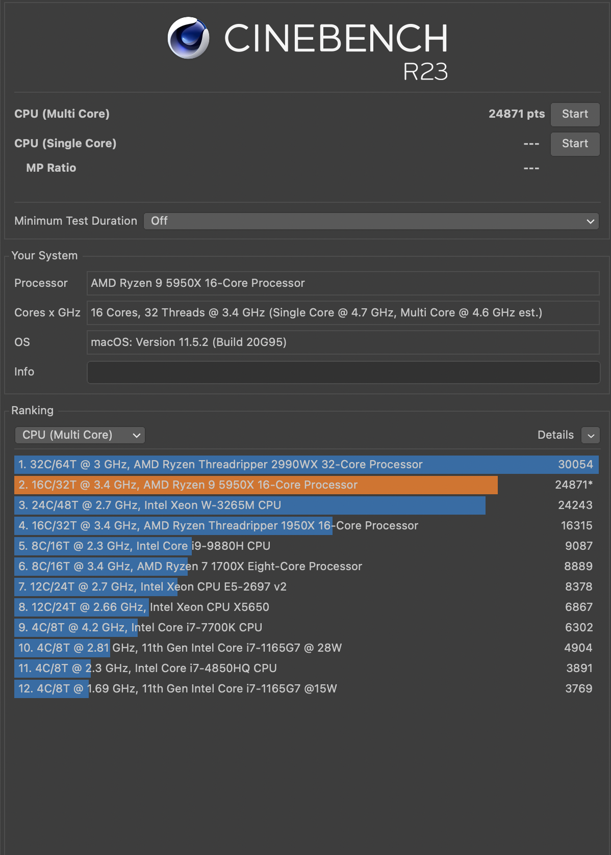

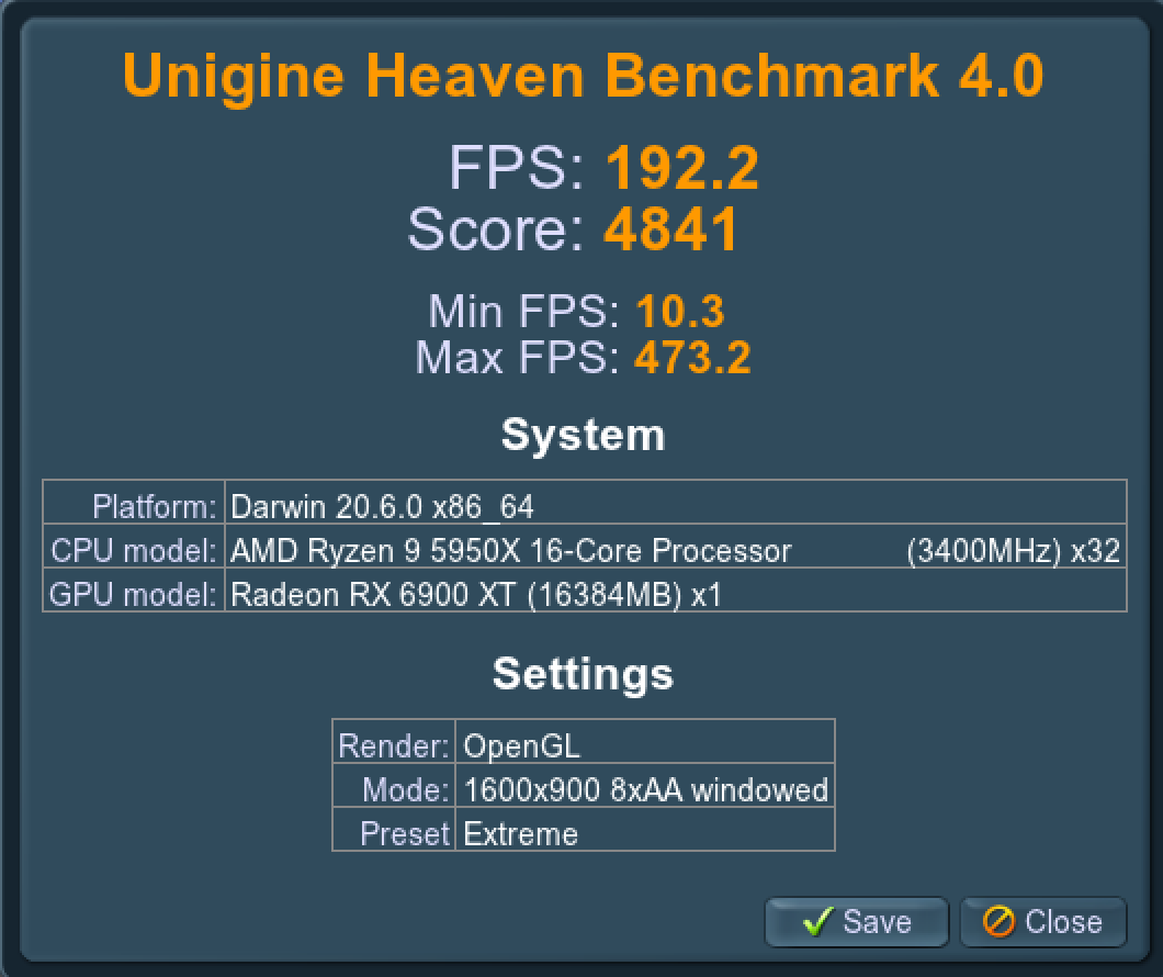

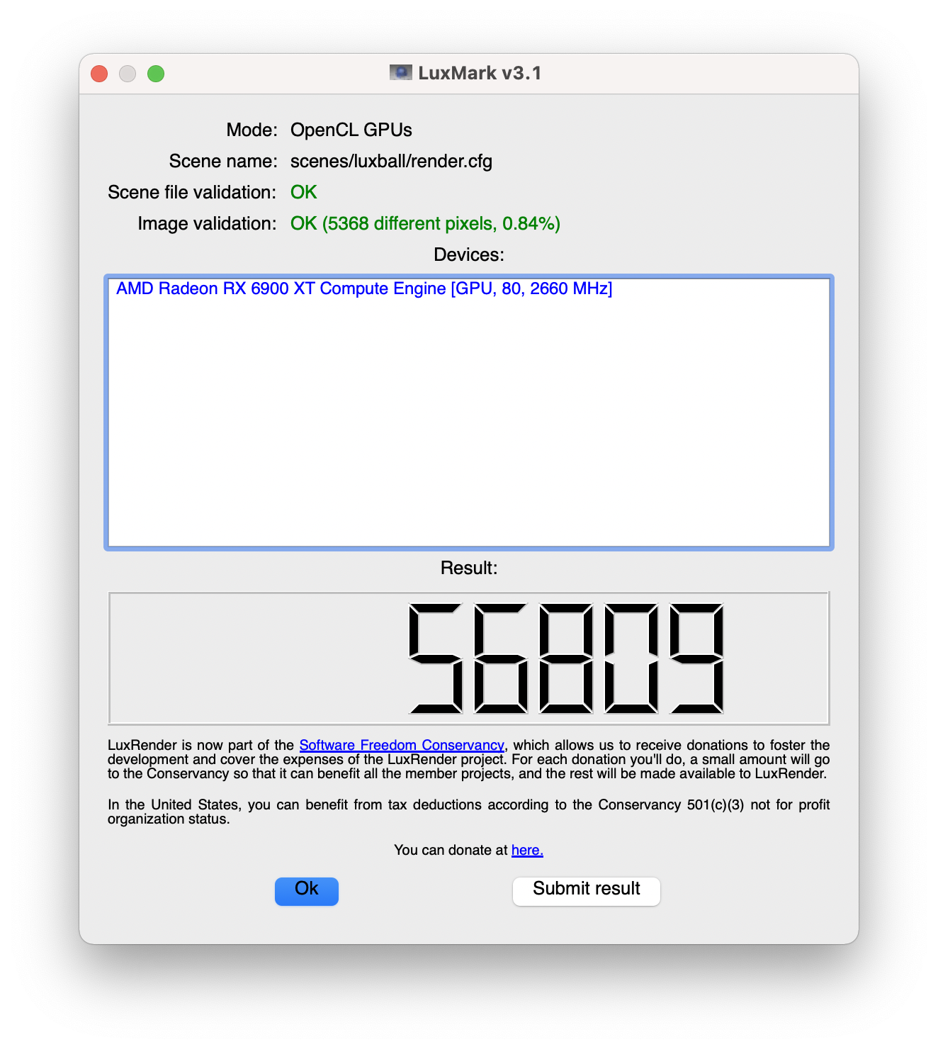

I ran a few benchmarks

my XFX 6900xt can’t output 4k 144hz , I’m stuck on 4k 60hz.
Do I need to do anything to enable DSC ?
My RX 6800 outputs 144hz no problem. Have you tried a different DP cable?
I’ve been using the same cable and it works in windows 10 before.
Should work with nothing doing in that case unless your monitor isn't liked by MacOS.
There might well be a workaround but not that I am aware of it I’m afraid.
Heres a thought, If you are not using a HDMI cable then you can try disabling WhateverGreen as I find BigNavi GPUs run better without it but at the cost of the hdmi out. That might kick the res you are after Into gear.
running real macs M1, I get full 4k 144hz. so, it must be something with my config. I’ll try disabling whatevergreen with -wegoff and see how it works
You can just disable the kext in the kernel so it doesn’t load at all.
And use your USB installer to test EFIs with so if it all goes wrong you can boot back in using the main EFI
Still the same with WhateverGreen disabled in the kernel.
The OS sees the 4K screen as 5K:
