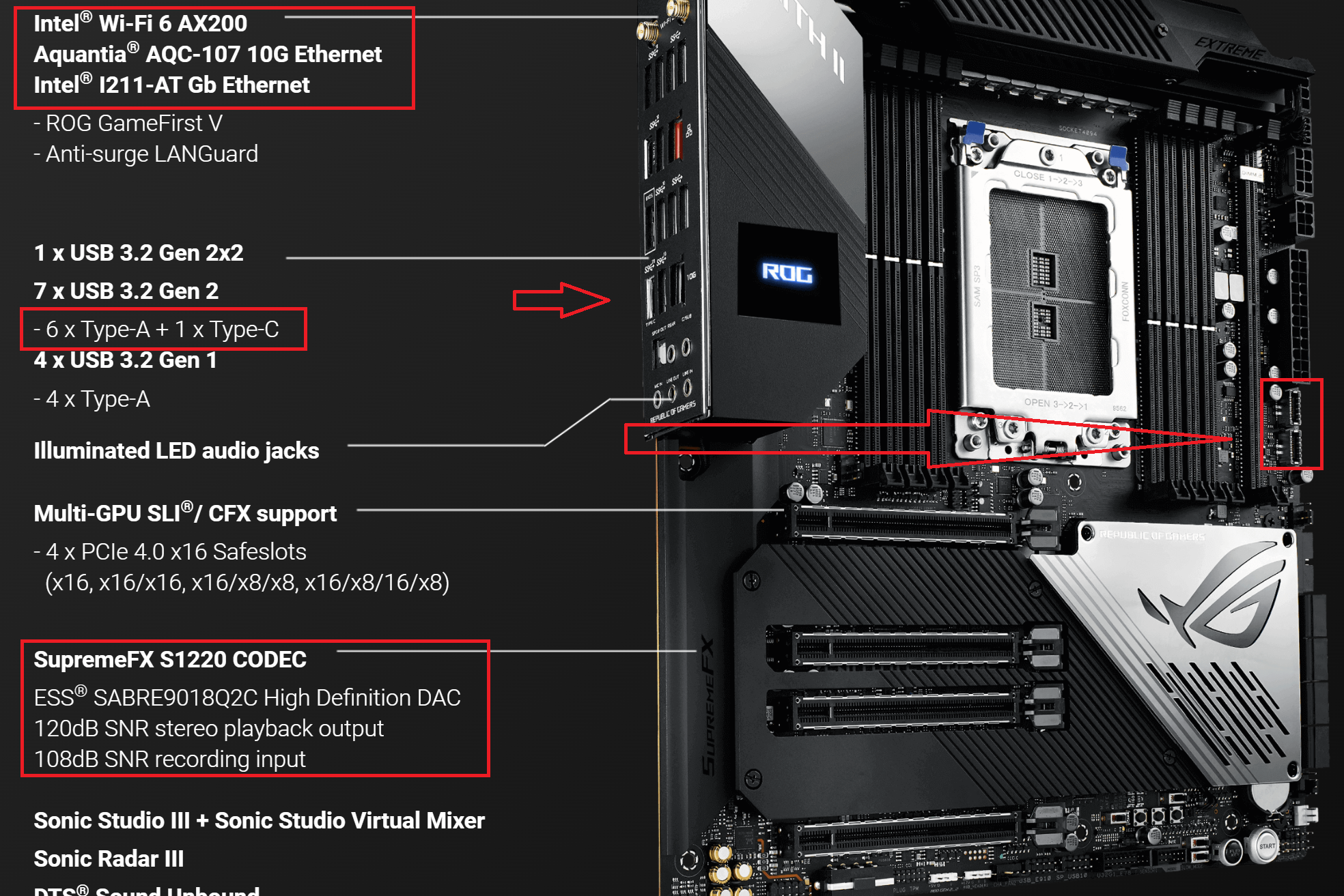

@ddk So to set things straight:
You have an Asus ROG Zenith II Extreme motherboard, NOT an Asus ROG Strix TRX40 motherboard, yes?
The Intel i211-AT Ethernet controller is known to be problematic when running MacOS Monterey as the IntelSmallTrees driver, which worked in Big Sur, doesn't work in Monterey. Some people have been fortunate to find that their i211-AT Ethernet ports work with a recent beta of AppleIGB.kext - see attached kext. Remember you need to add an entry for the kext in your config.plist, as well as adding the kext to the /OC/Kexts folder.
For your Aquantia 10GBe port you need to use a modified kext patch when running macOS Monterey. The screenshot below shows two versions of the kext patch for the Aquantia 10GBe controller. Patch 0 is for Big Sur, Patch 1 is for Monterey.

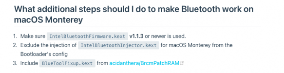

Your Bluetooth if supported, requires that you follow these instructions for Monterey:
Copies of the IntelBluetoothFirmware and BcrmPatchRam folders are attached below. Use the kexts as instructed above.
Your Realtek ALC1220 Audio codec should work with the addition of AppleALC.kext to your /OC/Kexts folder plist the corresponding entry in your config.plist.
What is also required is the addition of a compatible layout-id in the config.plist.
The Realtek ALC1220 can be successfully enabled using one of these layout-ids - 1, 2, 3, 5, 7, 11, 13, 15, 16, 17, 21, 27, 28, 29, 30, 34, 35, 98, 99, 100 - depending on how the system manufacturer has implemented the Audio codec.
You will need to try each and every one of the many id's listed above, till you find one that works with your system. There is no shortcut for this as it requires you to do the following:

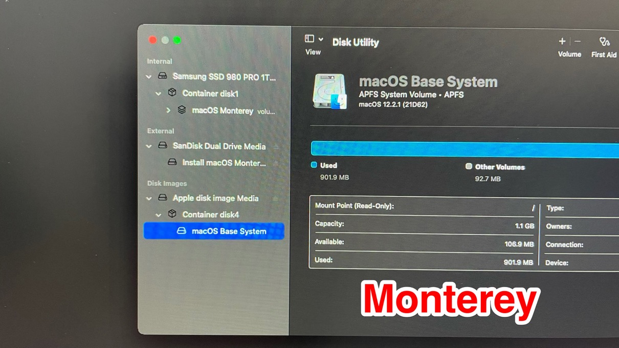

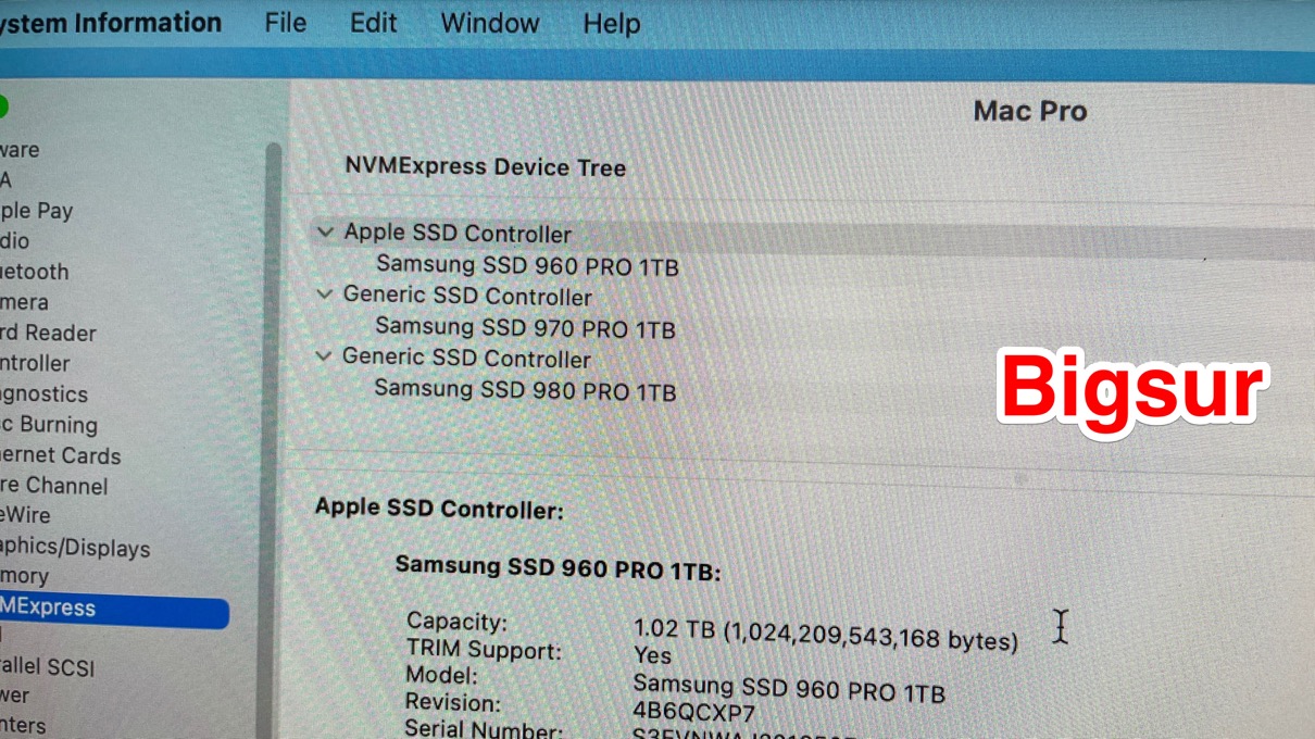

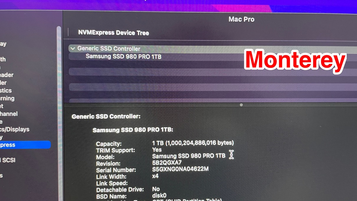

I've facing a really weird problem, my EFI (attached) is working well with BigSur, even iMess, AirDrop, Handoff, SideCar..
I used that EFI to install Monterey, the OS can be installed, but
- no wifi, BT, ethernet can be detected (nothing, except the GPU and CPU shown correctly)
- I had 3 SSDs (SS960, 970, 980 Pro), Monterey see only SS980 (as same as when start installing)
I spent weeks, but still...living in the Spain without the "s" now.
Can some one have a look into my EFI and tell me what's my guilty.
Any helps would be much thanked and appreciated.

Yes as you can see my post above I've lost everything in Monterey except a couple of USB hub and CPU/GPU ,
we back to stone age lol,
don't bother searching for solution, I've been searching for 4 weeks nothing, just wait at least 6 months and then search again.
In short words Hackintosh age is almost dead, I went to OSX-KVM week ago, im happy with it.
