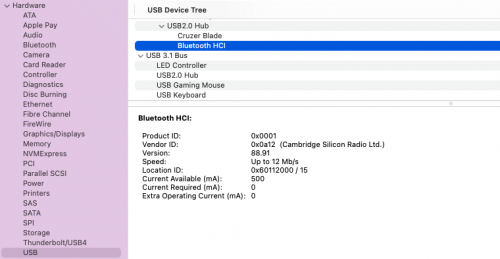

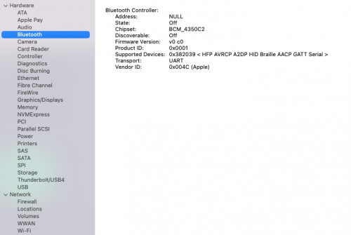

I am a newbie and know little bid on hackintosh. Already running Big Sur without any issue. Now Tried to have Monterey. But after so much of trouble successfully booted in to Monterey 12.6.1. But I could not make the following work :
1. TPLINK UB400 Blutooth dongle. -- Already tried BRCM patches
2. USB 2.0 Ports are not working -- Tried USBToolbox kexts
Any ideas, please help. Attached my plist for ready reference.

Your Bluetooth dongle uses a CSR chipset (Cambridge Silicon Radio) not a Broadcom chipset. It was known to work in macOS Catalina without any need to add any kexts. But this changed when Big Sur was released. The Broadcom kexts in your OC setup will not activate your TP-Link UB400 dongle as it doesn't use a Broadcom chip.
Have a look at the list of Broadcom compatible BT modules listed on the BrcmPatchRam Github page:
BrcmPatchRAM - supported BT modules
Hi.. Based on your advice, I have done some changes in my EFI. Have updated OC to 0.8.5, updated config.plist, removed unnecessary SSDTs and KEXTs. Now USB mapping is good. However, I could not enable my TP Link UB400 Bluetooth to work in Monterey 12.6.1. my EFI is enclosed herewith. pl. guide. Thanks.

Found a solution for Blutooth issue : Just use BRCM patch RAM version 2.6.2 not the latest one.. as the latest one (2.6.4) needs letest lilu. Now my blutooth working fine. Thanks guys for your support.
