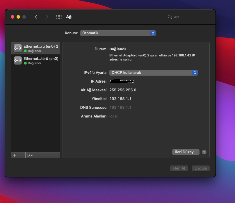

Yes I set before. My IP address dns everything it just keep connected and not connected writes at the status like a said one red one green. The times between 0.5 second

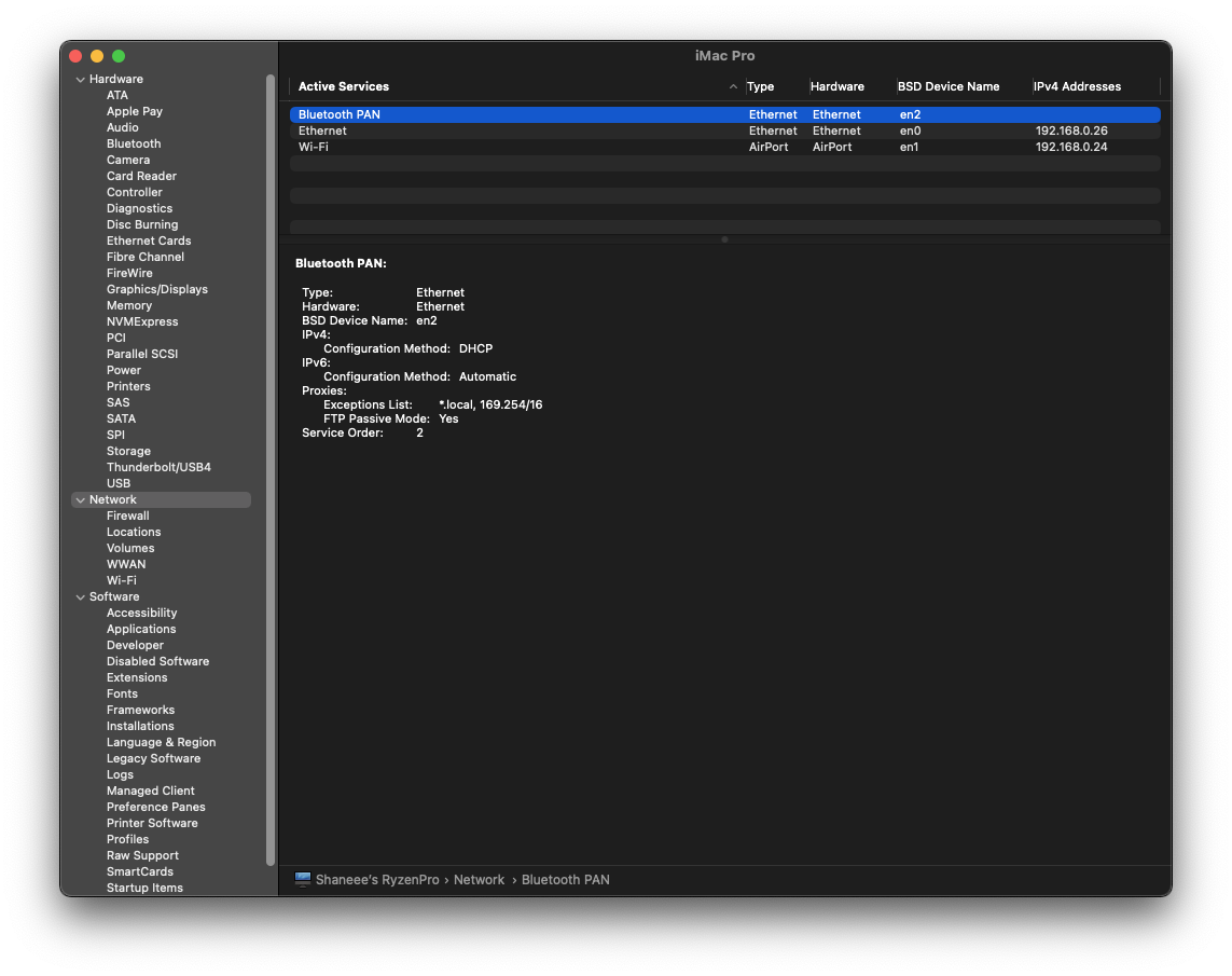

this is network window video right now. And yes everything’s fine at the windows. Weird thing is. This is my 20-25 turn. Work 2-3 times.
