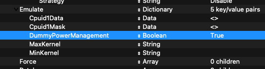

Have you made sure you have set the following entries in your config.plist:
Kernel > Emulate > DummyPowerManagement = True

ProviderCurrentCpuInfo was missing in my config.plist. I had it in my Big Sur config.plist. All the other things I elements I had in my Big Sur EFI and were updated before updating to Monterey. A new checklist item I need to be made aware of before updating on a Ryzentosh.
