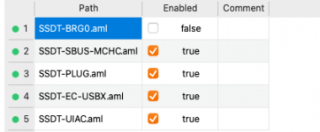

ACPI SSDT's
- All bypassed for other OS

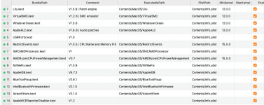

Kexts

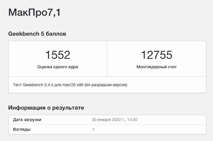

I noticed the brakes on the video card, on the screen saver, and it gives out only 82000 on Geekbench 5
How did you solve the brakes? Did you change something at the EFI? Thanks
