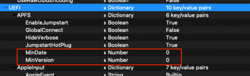

Hello
i have AMD FX-6300 Installation Problem
i'm trying to install mac os monterey on my pc
i got this error message
OCB: LoadImage failed - Unsupported
can anyone help me to fix this
Thanks

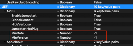

The UFEI > APFS > MinDate and MinVersion entries are set as '0' in your config.plist, these should be set as '-1', both of them, as shown below.
Screenshot 2022-01-01 at 18.10.45.png Your config
Screenshot 2022-01-01 at 18.11.07.png Amended entries
See if making these changes helps.
