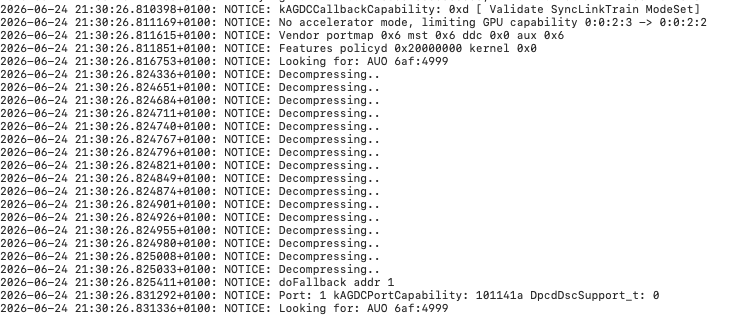

Using Whatevergreen (instead of nootedblue) (latest version) putting only AAPL,ig-platform-id taken by the previous "nootedblue conf" it gives to me a
iGPU : Generic iGPU 15MB
PCIe : Intel Raptor Lake-P [Iris Xe Graphics]
AAPL,ig-platform-id <02005C8A>
device-id <A0A70000>
setting this too :

- and emulating kernel like this (https://chriswayg.gitbook.io/opencore-visual-beginners-guide/advanced-topics/using-alder-lake) but maybe tter inserting Ice Lake kernel datas (i applied the Fake but setting the Ice Lake CPU ID 0x0706E5, instead of Coffee lake of the guide mentioned) :
XML:
Cpuid1Data : E5060700 00000000 00000000 00000000
Cpuid1Mask : FFFFFFFF 00000000 00000000 00000000
It's working but still 15 MB of RAM on system informations and no acceleration (either metal or QE/CI graphics acceleration didn't work)
So, today i discovered that there is a little bit accent of support tò Raptor Lake gen.. i think i must wait future release of Whatevergreen tò have full support.. or maybe i'm not seeing right the Hackintool logs ..
That's interesting, we found the same thing about 3 years ago trying to get Ice Lake based NUCs iGPUs working. As of today no change and not much hope of changes to happening to Whatevergreen.kext. macOS without graphics acceleration :(
