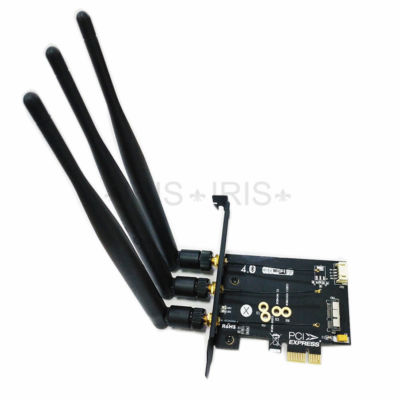

You will need a PCIe adapter to get the Apple Card working, you will also need a spare Motherboard USB2 header port for the Bluetooth connector from the PCIe adapter card.
s-l1600.jpg Adapter card for BCM4360CS2 WiFi/BT card
s-l1600-2.jpg Typical package contents for adapter card.
Examples of the adapter cards I have purchased from Amazon.co.uk & eBay.co.uk are linked below.
This assumes you will be using a PCIe slot for the wifi.

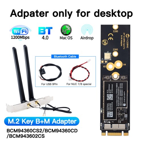

IF you are going to remove the Intel WiFi/BT card and install the Broadcom card in the M.2 connector on your motherboard then you need a different type of adapter.
Something like this would be required if the M.2 connector was used.
s-l1600-3.jpg M.2 adapter for BCM4360CS2 card
