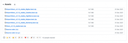

Things to keep in mind when using Intel WiFi/Bt and running Monterey.
  1. AirportItlwm.kext comes in different versions for each major release of macOS.
    1. So the kext that works in Catalina won't work in Monterey, you need to replace the Catalina kext with the appropriate kext for Monterey, Big Sur & soon Ventura.
    2. Screenshot 2022-09-27 at 17.44.10.png Release options for Airportitlwm.kext etc.
    3. https://github.com/OpenIntelWireless/itlwm/releases/tag/v2.1.0

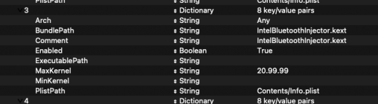

  2. IntelBluetoothInjector.kext doesn't work in macOS Monterey.
    1. You have to add a MaxKernel entry of 20.99.99 to prevent it being loaded by OC in Monterey, so it continues to works in Big Sur and older.

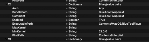

  3. You have to add BlueToolFixup.kext to get your Intel Bluetooth working in Monterey.
    1. This is available from the BrcmPatchRam repository
    2. https://github.com/acidanthera/BrcmPatchRAM/releases/tag/2.6.3
    3. You have to add a MinKernel entry of 21.0.0 to only allow this kext to work in Monterey or newer.

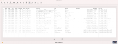

Regarding your Intel Ethernet controller, can you post a screenshot of your Hackintool > PCIe tab. With the tab fully expanded so I can see which Ethernet controller is being used by your motherboard. The reason for wanting to see this is that you have 3 x Intel Ethernet kexts in your OC setup and you should only need one. Below is an example of a fully expanded PCIe tab screenshot.
Screenshot 2022-09-27 at 17.55.06.png Hackintool > PCIe tab example

Hello @Edhawk here are the images you requested. I also added a zip file of the text doc that I exported from my list. I now have access to the BT screen, but it does not search for anything. It is able to be toggled on and off. My system is booting much faster now as well. Just like loading Catalina or Big Sur.

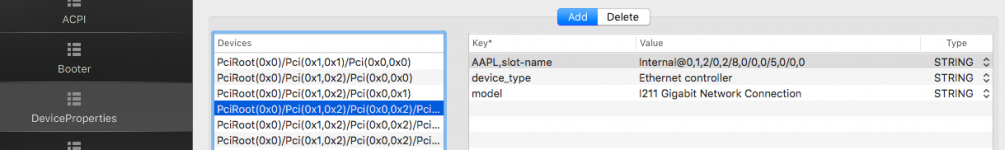

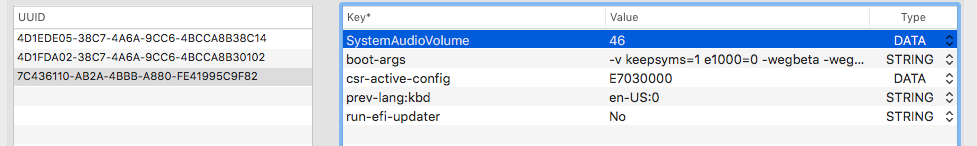

Okay, under your device properties try these:

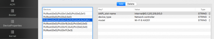

And under your boot-arg add e1000=0. And disable any Intel or Realtek LAN drivers that you currently have.
@DancingShinryu,
For the WiFi I forgot to mention but in addition to the above settings I would try to use the Monterey stable version of the Airportitlwm.kext as yours would be the Intel AX201 so should work.

Hmmm so I found the problem (I think). I don't know why, but I did not have the entry "csr-active-config" and having it set to "EF0F0000". I also needed to do a ResetNVRAM upon booting. I have Ethernet connection and is working. I will allow my machine to stay online for an hour and test the ethernet again. I have included some screenshots which appear a little different than yours @Middleman which is only the slots numbers. I haven't really learnt all that stuff yet.
Seems to be offline when the computer wakes from sleep. I needed to Toggle the speed in the advanced settings to get it back online. I decided to buy a cheap Realtek Ethernet Card from Amazon, I have removed the AppleIGB.kext and added the RealtekRTL8111Ethernet.kext V2.4.2. So far there hasn't been any issues. I'll test to see what happens when it wakes from sleep, but from what I read, there doesn't seem to be as many issues with Realtek.
Edit: It all looks great, no problems with the Ethernet at all. Thank you @Middleman @Edhawk for all your help. Now I'll create a full installer just in case anything ever goes wrong again. But I won't be doing any more upgrades, so all should be good. Thanks. ❤️
