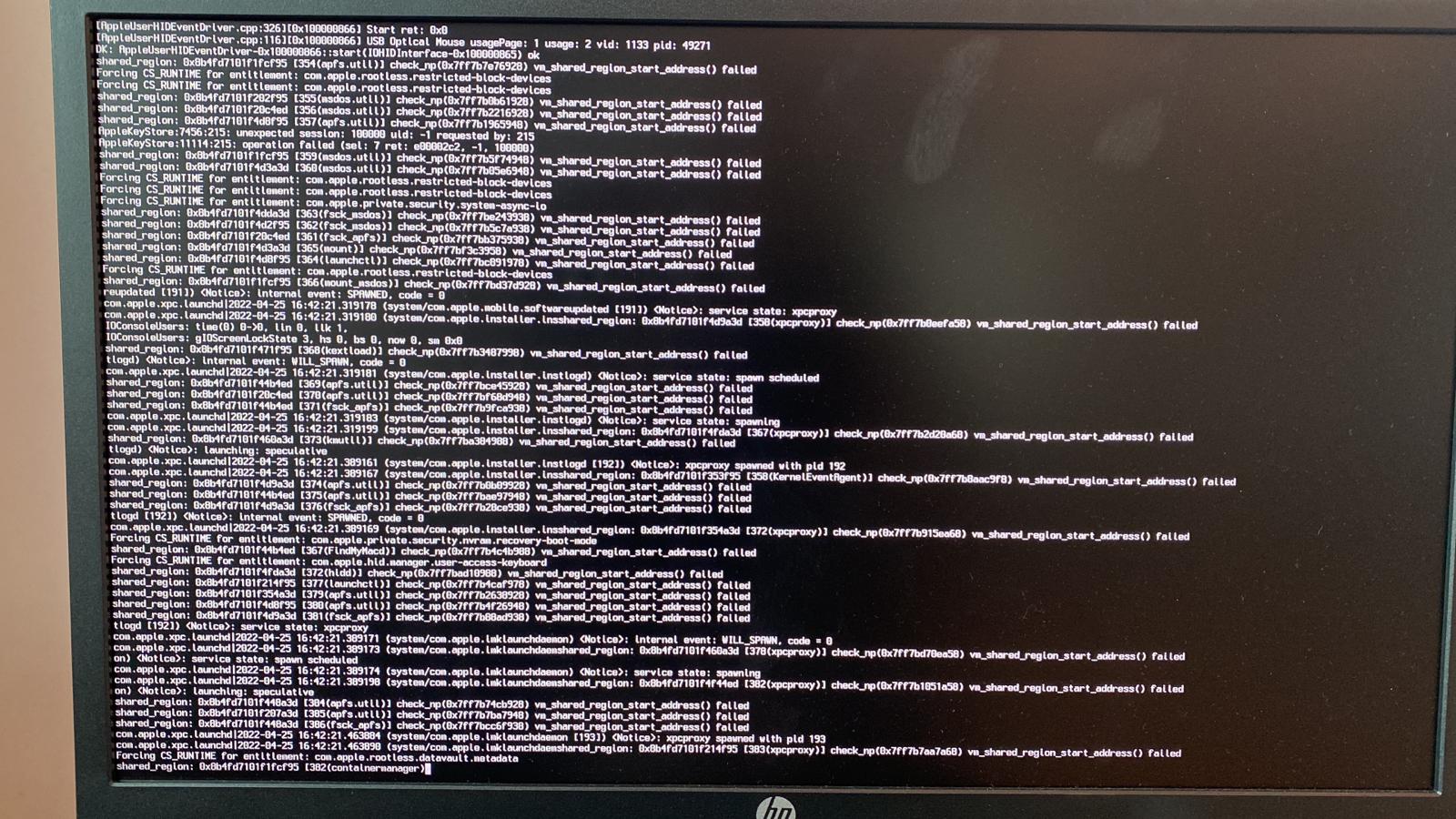

I tired this efi but its getting stuck on installation page.

2,382
Post a screen image of the Verbose text, assuming you get to that stage of the OC boot, so we can see what is happening.
The two debug files tell us little of use in solving the kernel panic.
2,382
That shows you are having issues with the APFS drivers. Possible caused by the MmioWhitelist entries in your config.plist.
I am going to assume you have not changed anything in the EFI I provided.
Here is a revised EFI, with the MmioWhitelist entries removed, the original SSDT's removed and replaced by a single generic SSDT-EC-USBX.aml table.
See if this EFI gets you past this APFS issue.
