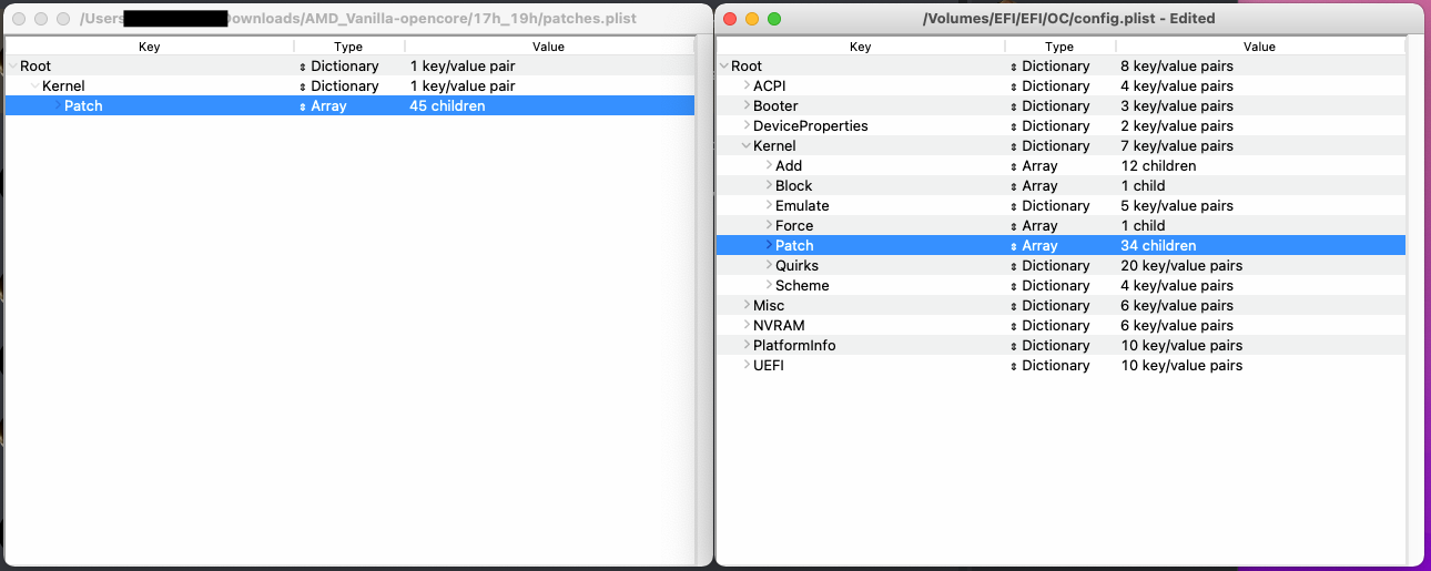

from 45 children's to 34 childrens
need to trim down further

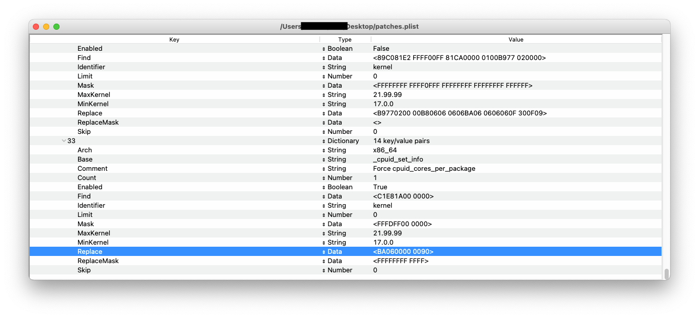

see attached patches with 34 childrens
my CPU have 6 cores so set these: Replace: BA0600000090, you can find this entries in #33dictionaries

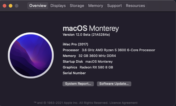

Installing now, so far so good. It boots and is installing Monterey B3, not yes tested other OS.
Still not tested other OS yet but i have to say Beta 3 is super smooth and super fast.

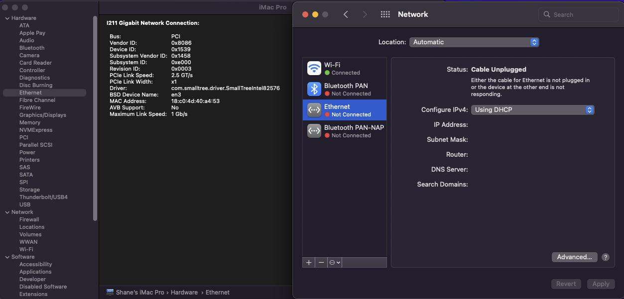

The only thing still not working is my ethernet which uses SmallTreeIntel82576.kext.
Hopefully someone smarter than i can come up with something, i have tried removing device properties, adding my subsystem ID in IOPCIPrimaryMatch with no luck
