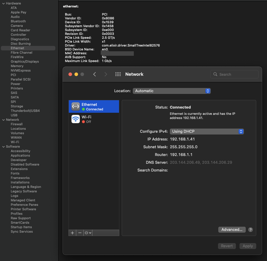

im on iMacPro1,1 and OC 0.7.2 and this is what i did
1. USB:
1.1 MISC > secure boot model = j137
1.2 PlatformInfo > SystemProductName = iMacPro1,1
2. SSD (Monterey Disk):
2.1 MISC > secure boot model = Disabled
2.2 PlatformInfo > SystemProductName = iMacPro1,1
3. restart and select USB to load OC
4. choose your SSD (Monterey Disk) to boot on the OS
5. go to system preferences > software update. ----> beta 7 update will now showing
6. select it to update
7. while updating..... you need to prepare your USB
8. USB:
8.1 MISC > secure boot model = Disabled
8.2 PlatformInfo > SystemProductName = iMac17,1
9. when update preparation complete, restart
10. select USB to load OC
11. let beta 7update to restart the Ryzentosh :p
12. after restart, be sure to select your SSD (Monterey Disk) to boot and complete the update.
confirmed that smalltree is alive and kickin :)
