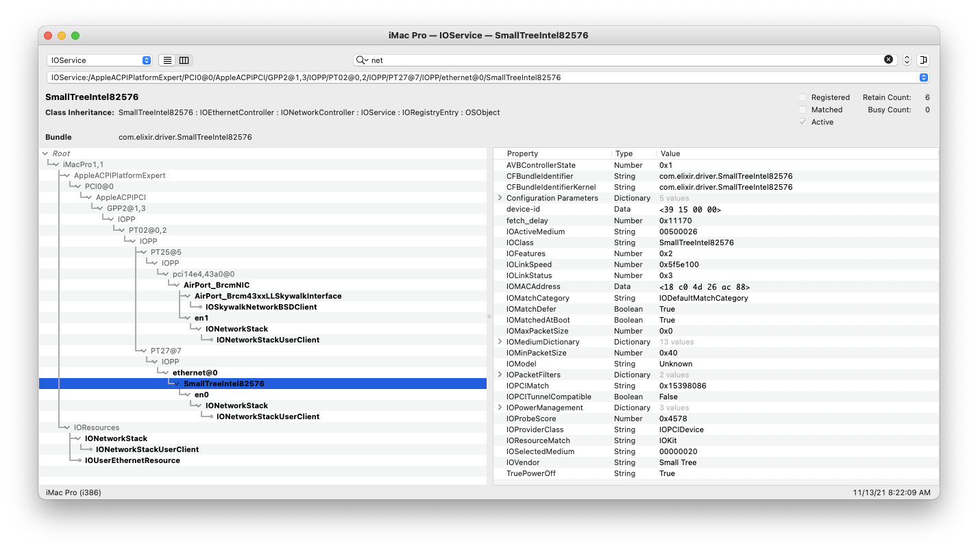

I'm an Intel guy with a Z390 Designare board that also has the i211 ethernet and for me AppleI2xx.kext works with Monterey without problems for several days now.
So thank you Shaneee (I tagged you in the tomato forum). Connection will still break with sleep but a change in MTU size will reconnect it.
Terminal type: networksetup -setMTU en1 1501 (use values around the original 1500, don't go crazy with it.. 9000 froze my system)
I have no way of knowing whether this will work for your AMD boards but imo worth a try

That does indeed work on AMD too. Nice find (y)

tested!!! smalltree is alive again.
thanks shaneee

Thanks Shaneee, for the link the method also works for the Intel I210 on a Trx40 motherboard.
Ps: For me, the Intel I210 worked until beta 10 included
