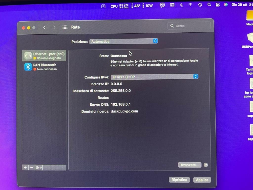

Tried on an asrock x570 steel Legend... Looks like MacOS sees Ethernet interface, but no way to get a DHCP address. Even setting manual up can't get it connected to internet/lan
I did cancel Old small tree kext, copied this, updated config.plist, rebooted, cleared nvram rebooted again, but still no way to let Nic interface working properly.
Even erasing/creating a brand new Ethernet interface from network settings won't help
Any idea?
