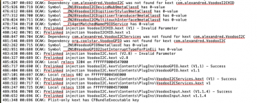

  4. There are a number of Drivers in the OC setup that are not being used/successfully activated. These should be removed from the Drivers folder and config.plist.
    1. Screenshot 2024-03-15 at 22.02.31.png screenshot form OC log showing unused Drivers.
  5. The BlackOSX OC boot theme seems to be lacking a few parts. It might be better to revert to the Acidanthera -Auto boot theme, just while installing macOS.
  6. VoodooI2C.kext is not being injected correctly. Not sure what is causing this 'Invalid Parameter' issue, as the Plugin kexts are all loading without issue.
  7. Screenshot 2024-03-15 at 22.23.37.png Voodooi2c.kext and other companion/plugin kexts injection success and failure.
  8. The VoodooI2CSynaptics.kext is not being injected.
  9. I am not sure that the ApplePS2Controller.kext will work with your laptop, as is a fairly old kext. The VoodooPS2Controller.kext might be a better option. Whichever you use they should never be used together, as that will just cause some unnecessary clashes.
  10. I don't think that SMCSuperIO.kext is required for any AMD system, it is aimed at Intel systems.
  11. You may need to add ECEnabler.kext to your /EFI/OC/Kexts folder and config.plist, to help with the Battery operation in macOS.

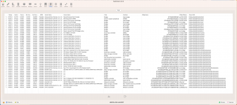

  1. Can you open Hackintool and do the following:
    1. Download and install the app, if you don't already have it installed.
    2. https://github.com/benbaker76/Hackintool/releases/tag/4.0.3
  2. Navigate to the PCIe tab.
    1. Screenshot 2024-03-17 at 20.07.15.png Hackintool > PCIe tab with Export icon highlighted
  3. Select the Export icon (bottom right side)
  4. This will generate 4 x files on the Desktop.
  5. Zip and attach the 4 x files so I can interrogate them.
Posting a screenshot showing the fully expanded PCIe tab would also be helpful.
Screenshot 2024-03-17 at 20.06.25.png Fully expanded Hackintool > PCIe tab example
