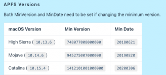

You should be using the correct UEFI > APFS > MinDate and MinVersion entries for the earliest version of macOS you want to run on this system, not '-1'. This is not recommended even by the OC developers.
Screenshot 2024-03-14 at 20.57.10.png APFS > MinDate and MiVersion entries.
View attachment 13494 APFS > MinDate and MiVersion entries.
I think that might be enough for you to be getting on with for now. Change your setup as recommended and then come back if you have any issues or questions.
