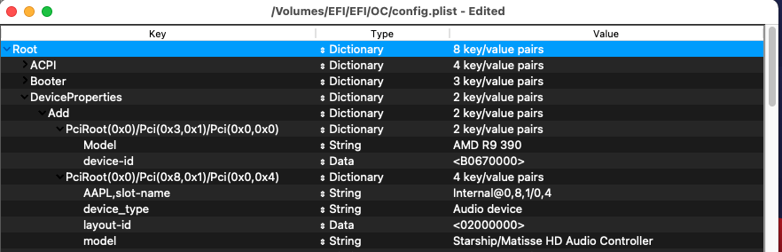

So, I deleted the Monterey disk and did the thing about making a new efi and hardware specific dsdt file. But it stalls on bootscreen. What is wrong/what did I wrong?
2,186
Stopping there is most likey either that you've not edited the kernel patches or enabled the ProvideCurrentCpuInfo quirk

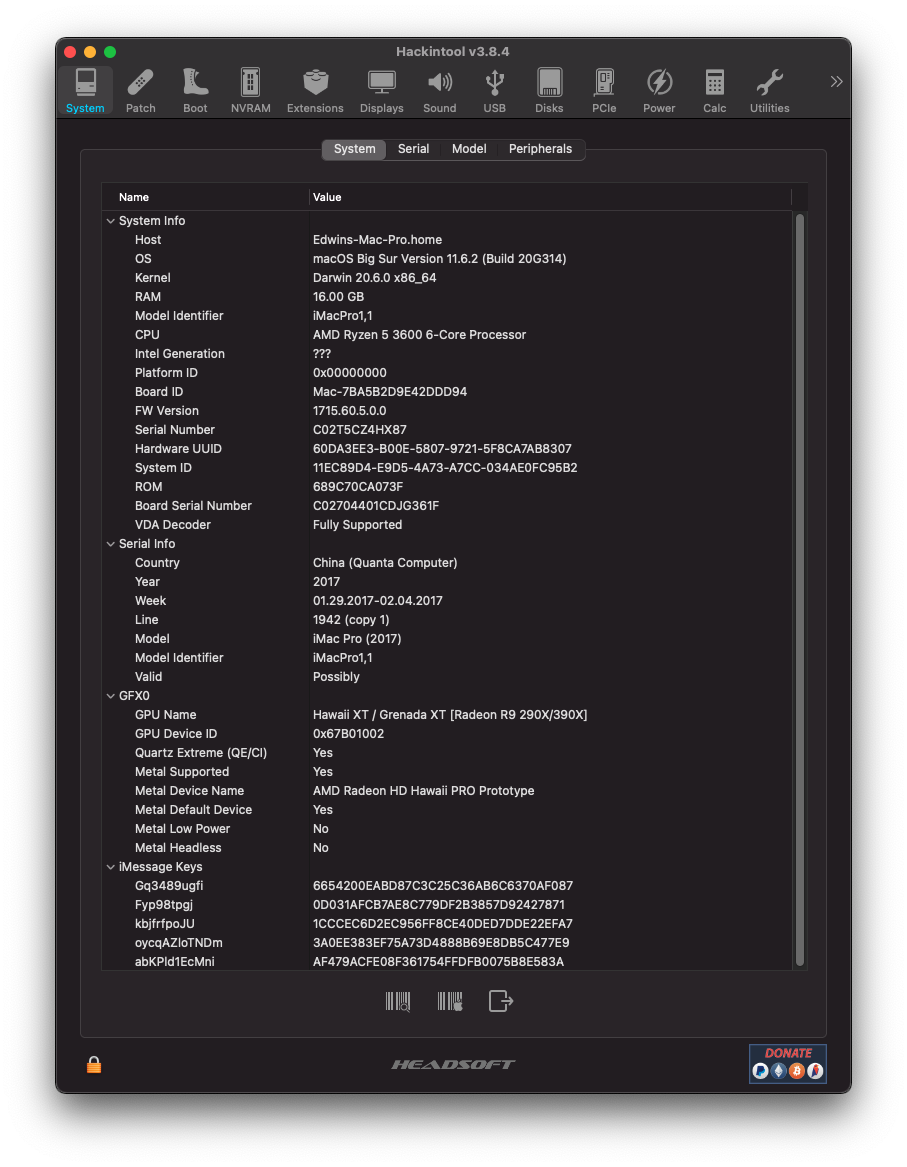

Hi Shanee, everything is up & running again. Big Sur that is. It's just the GPU. You mentioned earlier: "I'm guessing your PCI path for the GPU is wrong. Try with PciRoot(0x0)/Pci(0x3,0x1)/Pci(0x0,0x0)/Pci(0x0,0x0)/Pci(0x0,0x0) or check with gfxutil or Hackintool."
So I checked gfxutil and it showed this:

It's all abracadabra to me...
2,186
There's the one you need,
09:00.0 1002:67b0 /PCI0@0/GPP8@3,1/GFX0@0 = PciRoot(0x0)/Pci(0x3,0x1)/Pci(0x0,0x0)
Edwin
Jul 25, 2021
108
t
[QUOTE="Shaneee, post: 15907, member: 1"]
[CODE]09:00.0 1002:67b0 /PCI0@0/GPP8@3,1/GFX0@0 = PciRoot(0x0)/Pci(0x3,0x1)/Pci(0x0,0x0)
[/CODE
[/QUOTE]
[/QUOTE]

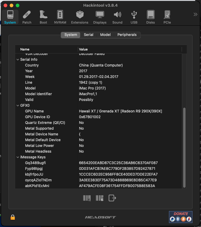

No Metal :-(
2,186
Doubtful but add this property on your GPU device property,
no-gfx-spoof = 01000000

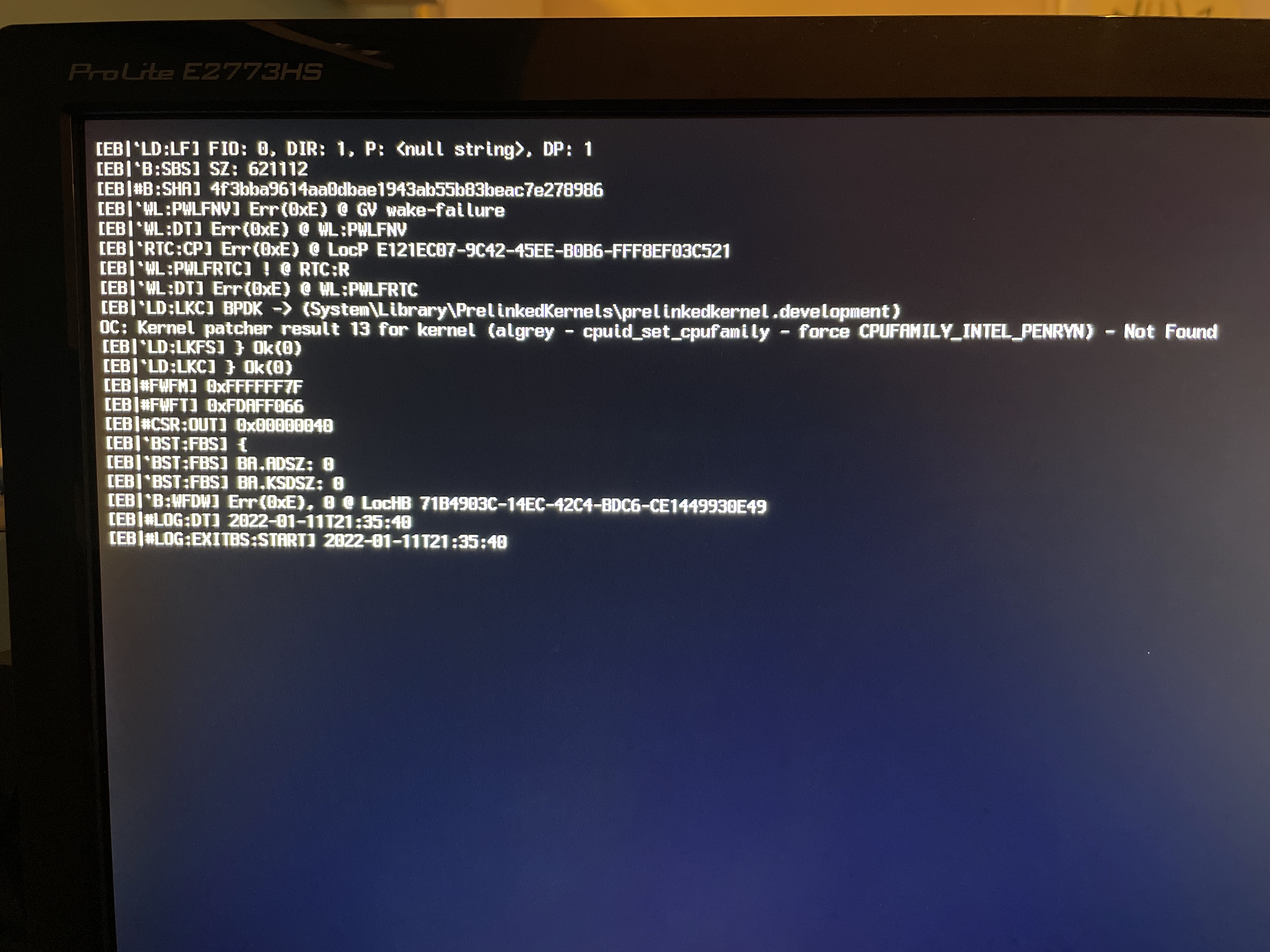

Just o.m.t. as Steve Jobs always says... Can you check this text file and are these errors to be solved?
  • opencore-2022-01-14-181948.txt
