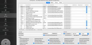

Hi,
I have a problem - I updated to 0.8.3 and everything is working but I don't have correct entries for Platform/Processor/Serial Number etc.
I'm attaching screenshot from About Mac and screenshot of my Config.plist
Do you have any idea?
Hi,

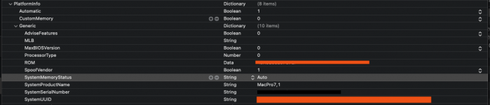

If you haven't already done so you'll need to use SSDTPRGen to create the UUID and serials. Then under your PlatformInfo set the data there into the fields shown below not forgetting adding the Processor Type and also enabling ProvideCurrentCPUInfo:
I did, and I see those entries in my Config.plist. Although they are not displayed in About Mac.
Try enabling RestrictEvents also and see if it helps.

Alright. Have you added SMCAMDProcessor.kext and AMDRyzenCPUPowerManagement.kext?
yes sir, and in AMD Power Gadget I see all details correctly.
Okay. The only thing I can think of is this. Try setting your Processor Type to 0
then reboot.
mr_1r0ny
Jun 12, 2021
13
then reboot.
I tried with 0 and with the other one but no change at all. Unlucko I guess :p
