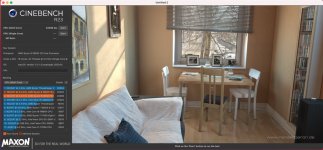

I changed my processor and it was a very fast show! AMD Ryzen 9 5950X 16-Core
See the photo below I installed the hacktools when I go to the boot tab he tells me that his EFI is in version 0.6.0 that I have to update did you see something like this?
Thanks again! for your Wonderful EFI ...

@Ezaul Clear your nvram and that should correct the version number that hackintool is seeing.
