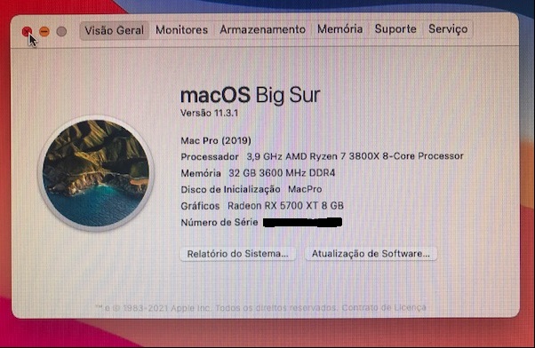

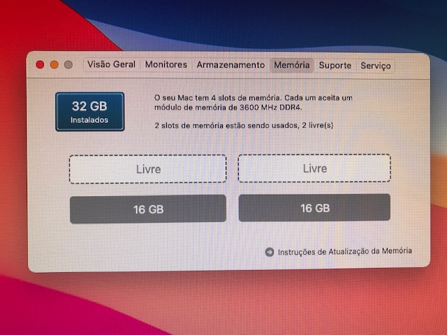

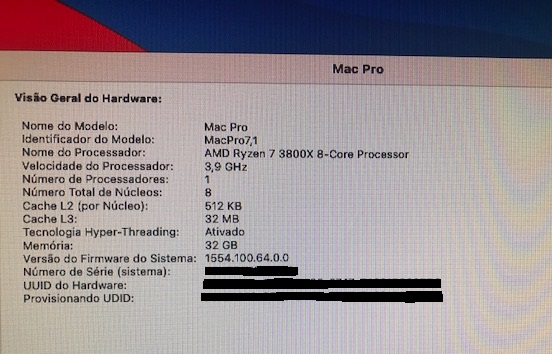

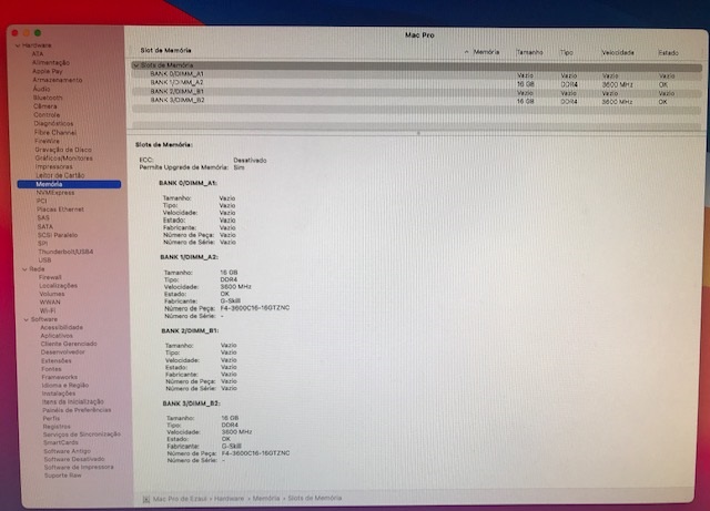

Good Morning...
First of all, I would like to congratulate you for the wonderful work you are doing in the very well done Efis with great quality and dedication if everyone were the same as you ...
Yesterday I updated your EFI 0.6.9 v1
I updated Big SUR 11.3.1
Since you have extensive knowledge, is there no fix for the microphone to work? I did some readings says it is a known problem of the sound drive with AMD processors?
Sorry my english i'm brazilian
Once again Thank you very much for the job!

@Ezaul Awesome buddy, I’m glad it’s all working for you well. Good Suff.
As for the mic input, Theres no fix currently using AppleALC I’m afraid.
the kext VoodooHDA instead of AppleALC used to be a work around for the mic input but that has problems with BigSur 11.3.
In my opinion the best thing you can do is get yourself a cheap usb audio adaptor or even better a DAC of some sort that’s compatible with macOS out of the box. There’s plenty low priced ones of either devices Out there to buy.
