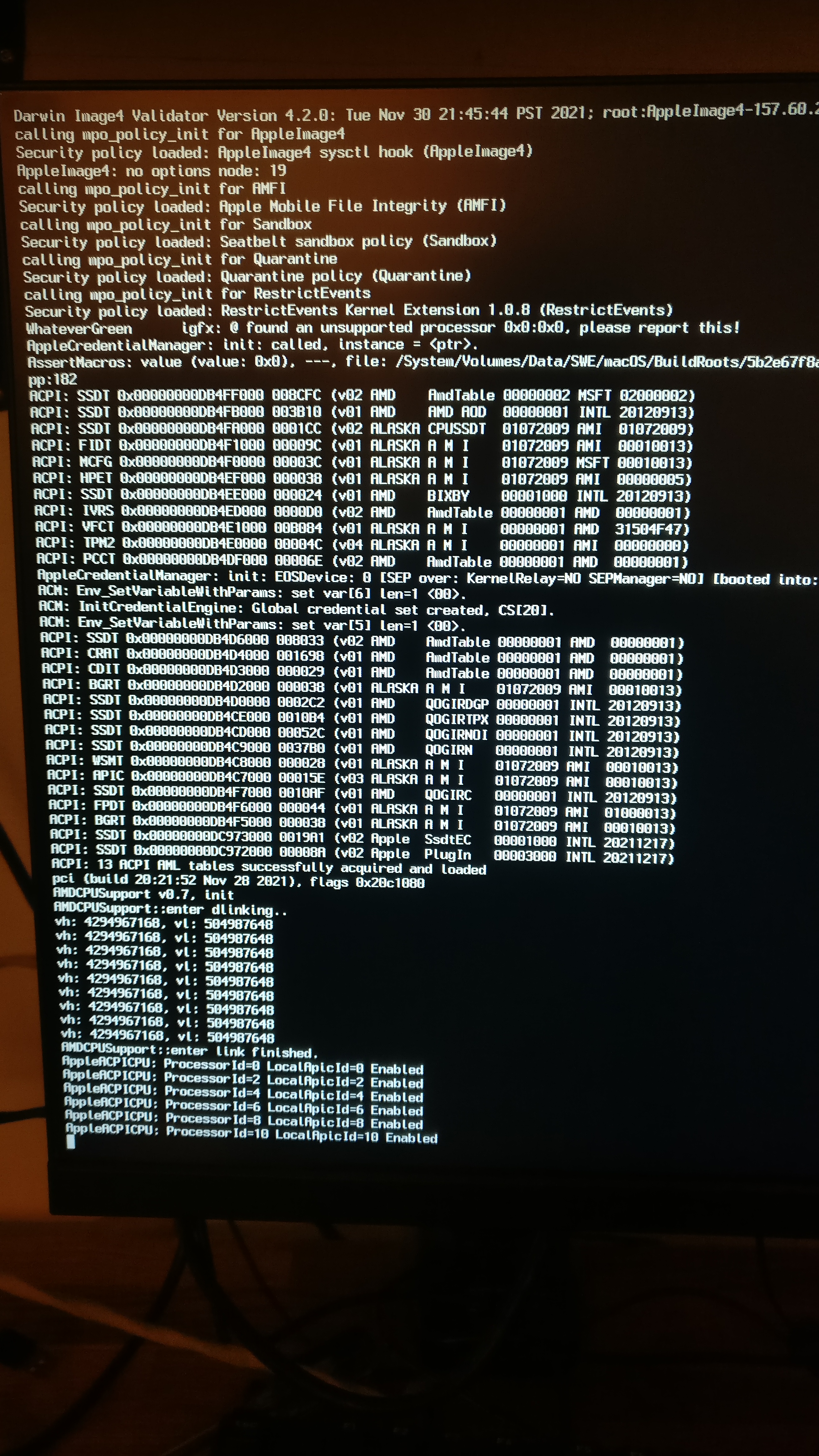

Hey guys
We are working on a project here with the specs above. But we cannot really seem to get the install loader to even get anywhere. I just had a go with the plist after my comrade gave it a go, and it seems I have just taken us a step back. Now the machine claims that it does not support OSX - so there must clearly be some larger issue with my plist identification values...? I will up the plist here.
CPU: 5950X
GPU: 6700XT
MOB: MSI X570 Torpedo Max
SSD: Corsair MP600 Core (4 TB) - I know, long shot as nobody has tried it. But let's see. It's a Phison controller and I hope NVMe fix will atleast enable TRIM.
EDIT: The GPU is now a 6600XT. Please look past posts regarding incompatibility of 6700XT.

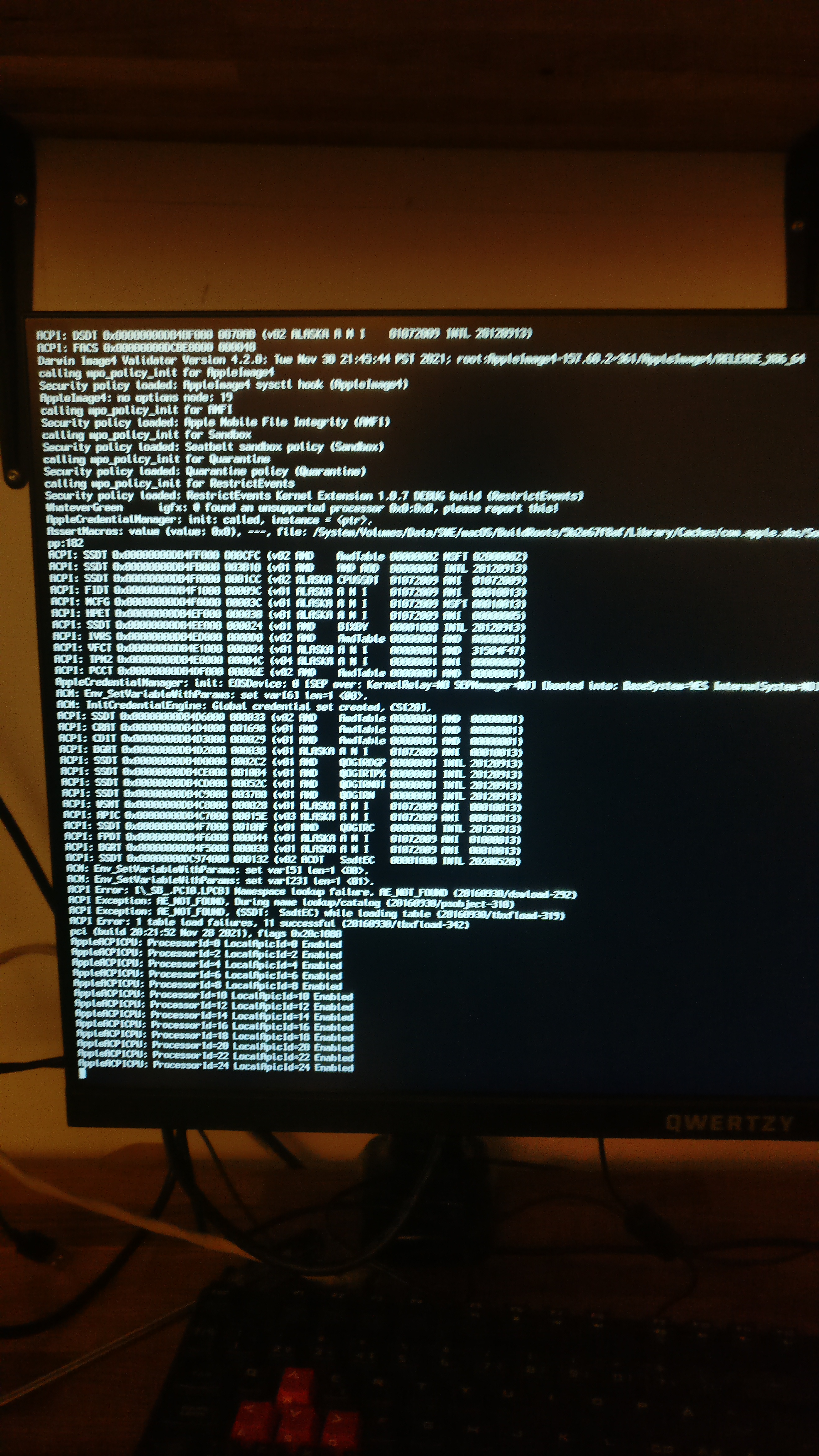

Okay. So I decided to redo the EFI folder with these:
-Desktop AMD Bulldozer, Jaguar, Ryzen and Threadripper
After that, I edited the plist as much as I could, according to this:
So yeah mainly just adjusting cores, and making sure that the ACPI>Add tables were adjusted.
So this is where I am atm:
