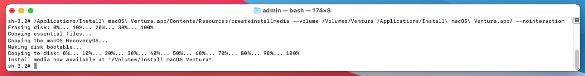

On a Mac you need to prepare the USB stick like this:
- Start Disk Utility, set "View" to "Show All Devices", so that the USB stick is visible in Device Mode. Click on the Device to activate it.
- Click on "Erase" and set the device name to "Ventura", Format = "Mac OS Extended (Journaled) and, important, Scheme = GUID Partition Map.
Now install the boot files with createinstallmedia. The output should look like this:
Mount the EFI partition and copy the EFI folder to it. The two partitions on the USB stick should look like this:

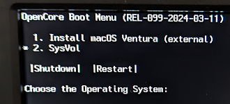

When you boot your Firebat with the USB stick, the stick should show as "Install macOS Ventura (external)

Thank you very much, I installed it successfully
