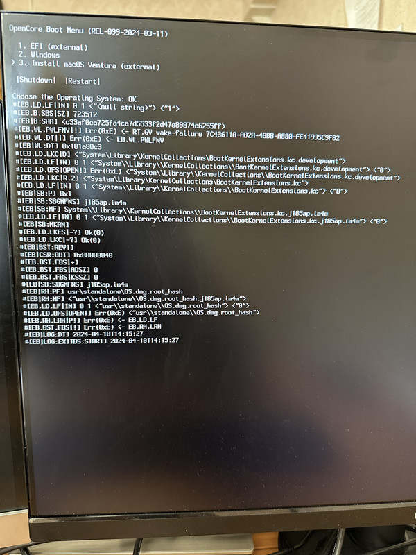

Thank you. I tried the kext AirportItlwm, IntelBTPatcher, IntelBluetoothFirmware and BlueToolFixup.kext in config.plist and switch the enabled line to "false" (is this enough to disable it?). I also checked the BIOS settings again.
It's still no result.
UPD: I try another M2 NVMe and that also has no result.
Which M.2 drives have you tried? Provide make and model identification for the two drives.
Post a copy of your current EFI folder so we can see what you are using.
I would also recommend you provide a copy of the system DSDT.aml, so we can see if the ACPI tables you are using are correct for your system. Using someone else's EFI can bring all sorts of issue to the fore, that weren't issues for the original user/creator.

Copy EFI и DSDT.aml
This is strange. I prepared a boot stick with your EFI, and it boots up just fine to the installer menu on my device. I also tried it with a "do not ever use these" Samsung 980 installed, also no problem booting to the install menu.
You could replace the OpenCore files with the "debug" version and hope that they will display a more meaningful error message.
Your DSDT.aml only differs from mine by three bytes:
G:\Temp>fc /b myDSDT.aml yourDSDT.aml
Comparing files myDSDT.aml and yourDSDT.aml
00000009: E0 72
00000699: 18 98
0000069A: BF AD
The only thing I could think of is some issue with the BIOS, or something is wrong with the USB stick - you could try a different brand.
My BIOS version is 2.22.1284, Date: 09/11/2023 11:05:27 Ver: D6D01022
