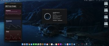

ok so doing the update naturally from catalina resulted in a kernel panic or so it seemed I did not give it much time. Just going to enable verbose and see if where it is hanging im already on open core 6.3.
Update : update fails. I am gonna follow the guide like you suggested any links on how to get BIg Sur to work with open core?
Update 2 : so after reading the guide for Big Sur Open Core, all i did was update my config.plist with the experimental patches and everything updates im on Big Sur 11 now let me do some testing to see what works but im booted and working so far all my apps still here.
